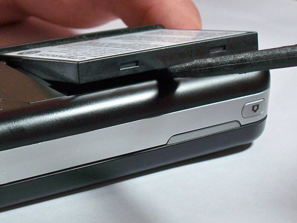

  3. UTStarcom XV6700 Motherboard Replacement: crwdns2935265:03crwdnd2935265:01crwdnd2935265:03crwdne2935265:0 UTStarcom XV6700 Motherboard Replacement: crwdns2935265:03crwdnd2935265:02crwdnd2935265:03crwdne2935265:0 UTStarcom XV6700 Motherboard Replacement: crwdns2935265:03crwdnd2935265:03crwdnd2935265:03crwdne2935265:0

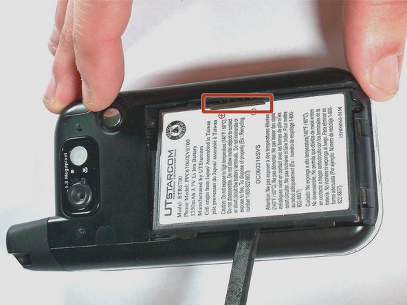

    • Pull the battery removal tab and lift the battery out of the phone.
    • If the battery removal tab is missing, place a spudger on the opposite side of the highlighted connector and pry the battery up.

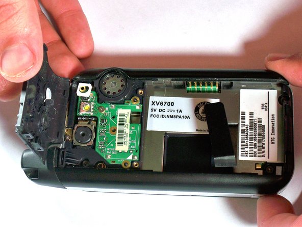

    • Use firm pressure to carefully pry off the cover with your fingers.
  6. UTStarcom XV6700 Motherboard Replacement: crwdns2935265:06crwdnd2935265:01crwdnd2935265:01crwdne2935265:0
    • Remove the 4.0-mm #00 Phillips screw securing the camera flash circuit board. The board is still connected by a connector on the bottom of the board.
  7. UTStarcom XV6700 Motherboard Replacement: crwdns2935265:07crwdnd2935265:01crwdnd2935265:01crwdne2935265:0
    • Gently pry off the camera flash circuit board with the spudger.
  8. UTStarcom XV6700 Motherboard Replacement: crwdns2935265:08crwdnd2935265:01crwdnd2935265:01crwdne2935265:0
    • Gently pry off the camera with the spudger.

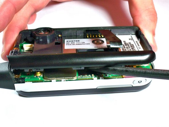

  11. UTStarcom XV6700 Motherboard Replacement: crwdns2935265:011crwdnd2935265:01crwdnd2935265:03crwdne2935265:0 UTStarcom XV6700 Motherboard Replacement: crwdns2935265:011crwdnd2935265:02crwdnd2935265:03crwdne2935265:0 UTStarcom XV6700 Motherboard Replacement: crwdns2935265:011crwdnd2935265:03crwdnd2935265:03crwdne2935265:0
    • Use the spudger or plastic opening tools to apply firm but gentle pressure equally around the outside of the case.
    • Carefully pry the black portion of the case away from the silver portion.

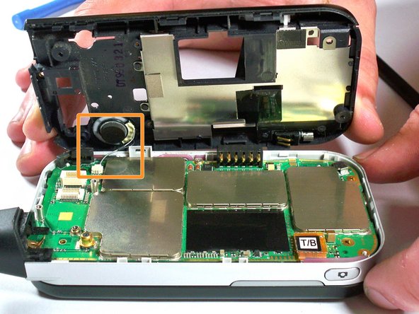

    • Do not try to remove the case completely. The speaker wire is still connected to the motherboard.
  12. UTStarcom XV6700 Motherboard Replacement: crwdns2935265:012crwdnd2935265:01crwdnd2935265:01crwdne2935265:0
    • Using tweezers, pull with gentle pressure in the direction of the wire to unplug from the motherboard connector.

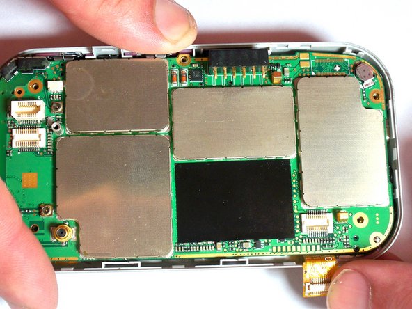

    • Remove the 4.0-mm #00 Phillips screw holding the motherboard in place. The screw is in the middle of the motherboard, near the outside edge.
  14. UTStarcom XV6700 Motherboard Replacement: crwdns2935265:014crwdnd2935265:01crwdnd2935265:02crwdne2935265:0 UTStarcom XV6700 Motherboard Replacement: crwdns2935265:014crwdnd2935265:02crwdnd2935265:02crwdne2935265:0
    • With your fingers, disconnect the keyboard cable from the motherboard. The cable is orange with the letters T/B printed on the connector.
  15. UTStarcom XV6700 Motherboard Replacement: crwdns2935265:015crwdnd2935265:01crwdnd2935265:02crwdne2935265:0 UTStarcom XV6700 Motherboard Replacement: crwdns2935265:015crwdnd2935265:02crwdnd2935265:02crwdne2935265:0

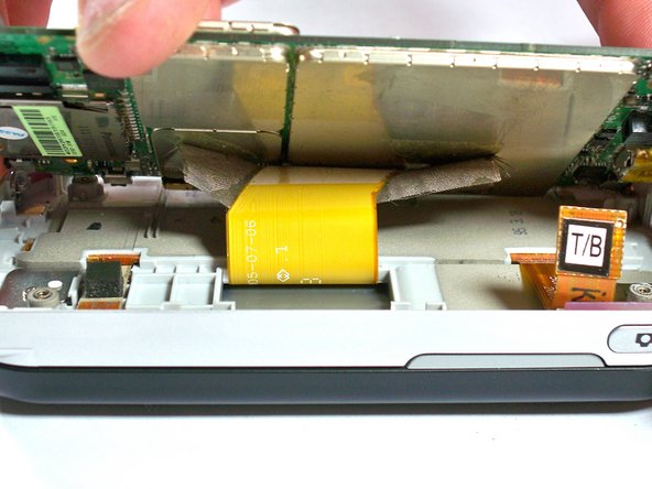

    • Carefully lift up on the motherboard with the spudger until you can see the display cable connected to the underside of the motherboard. The display cable connector will be taped over.
  16. UTStarcom XV6700 Motherboard Replacement: crwdns2935265:016crwdnd2935265:01crwdnd2935265:01crwdne2935265:0
    • Use the spudger to peel away the tape from the connector.
  17. UTStarcom XV6700 Motherboard Replacement: crwdns2935265:017crwdnd2935265:01crwdnd2935265:01crwdne2935265:0
    • Using the spudger, pry away the display cable connector from the motherboard. The motherboard is now completely disconnected.
