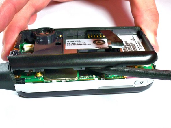

  11. UTStarcom XV6700 External Speaker Replacement: crwdns2935265:011crwdnd2935265:01crwdnd2935265:03crwdne2935265:0 UTStarcom XV6700 External Speaker Replacement: crwdns2935265:011crwdnd2935265:02crwdnd2935265:03crwdne2935265:0 UTStarcom XV6700 External Speaker Replacement: crwdns2935265:011crwdnd2935265:03crwdnd2935265:03crwdne2935265:0
    • Use the spudger and plastic opening tools to apply firm but gentle pressure equally around the outside of the case.
    • Carefully pry the black portion of the case away from the silver portion.
    • Do not try to remove case completely. The speaker wire is still connected to the motherboard.

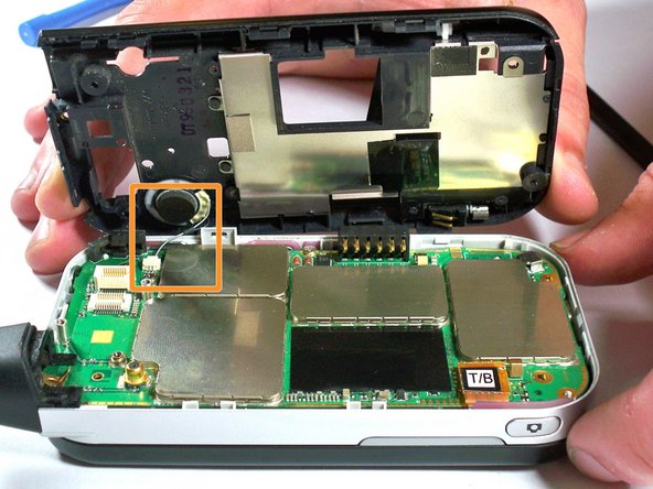

  12. UTStarcom XV6700 External Speaker Replacement: crwdns2935265:012crwdnd2935265:01crwdnd2935265:01crwdne2935265:0
    • Using tweezers, pull on the connector or wire in the direction of the wire with gentle pressure to unplug the wire connector from the motherboard.

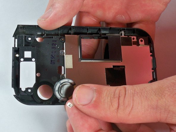

  13. UTStarcom XV6700 External Speaker Replacement: crwdns2935265:013crwdnd2935265:01crwdnd2935265:02crwdne2935265:0 UTStarcom XV6700 External Speaker Replacement: crwdns2935265:013crwdnd2935265:02crwdnd2935265:02crwdne2935265:0
    • Press your finger on the speaker from the outside of the housing, and the speaker will come out.
