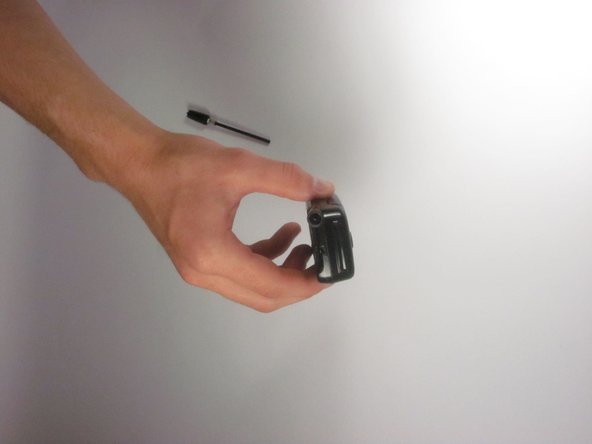

    1. UTStarcom CDM8945vw Keyboard Replacement, Antenna: crwdns2935265:03crwdnd2935265:01crwdnd2935265:01crwdne2935265:0
      • Identify the antenna. It is the extendable plastic component pictured here.
    2. UTStarcom CDM8945vw Keyboard Replacement: crwdns2935265:04crwdnd2935265:01crwdnd2935265:01crwdne2935265:0
      • Twist the base in a counter-clockwise motion to unscrew the antenna.
    3. UTStarcom CDM8945vw Keyboard Replacement: crwdns2935265:05crwdnd2935265:01crwdnd2935265:02crwdne2935265:0 UTStarcom CDM8945vw Keyboard Replacement: crwdns2935265:05crwdnd2935265:02crwdnd2935265:02crwdne2935265:0
      • The antenna should slide right out of the phone when finished.

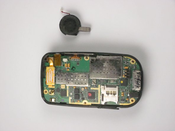

    1. UTStarcom CDM8945vw Keyboard Replacement, Speaker: crwdns2935265:06crwdnd2935265:01crwdnd2935265:01crwdne2935265:0
      • Remove the small rubber grommet using the plastic opening tool.
    2. UTStarcom CDM8945vw Keyboard Replacement: crwdns2935265:07crwdnd2935265:01crwdnd2935265:01crwdne2935265:0
      • Remove five screws using a Phillips #00 screwdriver.
    3. UTStarcom CDM8945vw Keyboard Replacement: crwdns2935265:08crwdnd2935265:01crwdnd2935265:01crwdne2935265:0
      • Use the plastic opening tool to separate the two pieces that form the outer case of the phone.
      • Prying the two pieces apart may be difficult. Carefully apply a moderate amount of pressure when attempting to separate the two pieces or else you will risk breaking them.
    4. UTStarcom CDM8945vw Keyboard Replacement: crwdns2935265:09crwdnd2935265:01crwdnd2935265:01crwdne2935265:0
      • Remove the back piece of the outer case.
    5. UTStarcom CDM8945vw Keyboard Replacement: crwdns2935265:010crwdnd2935265:01crwdnd2935265:01crwdne2935265:0
      • Remove the speaker using a plastic opening tool.
      • Apply a small amount of force when removing the broken speaker from the motherboard. If you apply a large amount of force, you may rip out the wires and damage the motherboard.
    6. UTStarcom CDM8945vw Keyboard Replacement: crwdns2935265:011crwdnd2935265:01crwdnd2935265:02crwdne2935265:0 UTStarcom CDM8945vw Keyboard Replacement: crwdns2935265:011crwdnd2935265:02crwdnd2935265:02crwdne2935265:0
      • Remove the wire attached to the speaker from the motherboard using tweezers.
      • Apply a small amount of force when removing the wire from the motherboard. If you apply a large amount of force, you may rip out the wires and damage the motherboard.

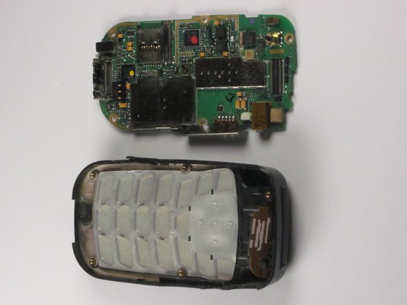

    1. UTStarcom CDM8945vw Keyboard Replacement, Logic Board: crwdns2935265:012crwdnd2935265:01crwdnd2935265:01crwdne2935265:0
      • Detach the highlighted piece from the logic board using a plastic opening tool.
    2. UTStarcom CDM8945vw Keyboard Replacement: crwdns2935265:013crwdnd2935265:01crwdnd2935265:02crwdne2935265:0 UTStarcom CDM8945vw Keyboard Replacement: crwdns2935265:013crwdnd2935265:02crwdnd2935265:02crwdne2935265:0
      • Remove the logic board from the anterior piece of the outer case using the plastic opening tool.
