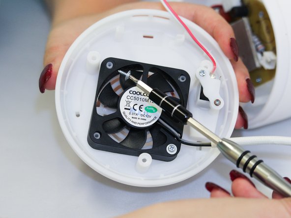

    • Unplug the Oil Diffuser.
  2. URPOWER V2 Ultrasonic Aroma Essential Diffuser Fan Replacement: crwdns2935265:02crwdnd2935265:01crwdnd2935265:02crwdne2935265:0 URPOWER V2 Ultrasonic Aroma Essential Diffuser Fan Replacement: crwdns2935265:02crwdnd2935265:02crwdnd2935265:02crwdne2935265:0
    • Using a Phillips #00 screwdriver from the iFixit kit, remove all three 10.0 mm screws on the bottom piece.
  3. URPOWER V2 Ultrasonic Aroma Essential Diffuser Fan Replacement: crwdns2935265:03crwdnd2935265:01crwdnd2935265:01crwdne2935265:0
    • Remove the bottom piece of the Oil Diffuser.
    • Be careful not to lose the outside light and air buttons.
  4. URPOWER V2 Ultrasonic Aroma Essential Diffuser Fan Replacement: crwdns2935265:04crwdnd2935265:01crwdnd2935265:02crwdne2935265:0 URPOWER V2 Ultrasonic Aroma Essential Diffuser Fan Replacement: crwdns2935265:04crwdnd2935265:02crwdnd2935265:02crwdne2935265:0
    • Unplug the fan power cord.
  5. URPOWER V2 Ultrasonic Aroma Essential Diffuser Fan Replacement: crwdns2935265:05crwdnd2935265:01crwdnd2935265:02crwdne2935265:0 URPOWER V2 Ultrasonic Aroma Essential Diffuser Fan Replacement: crwdns2935265:05crwdnd2935265:02crwdnd2935265:02crwdne2935265:0
    • Using the Phillips #00, remove two 10.0 mm screws holding the fan onto the base of the diffuser.
  6. URPOWER V2 Ultrasonic Aroma Essential Diffuser Fan Replacement: crwdns2935265:06crwdnd2935265:01crwdnd2935265:01crwdne2935265:0
    • Remove and replace the fan.
