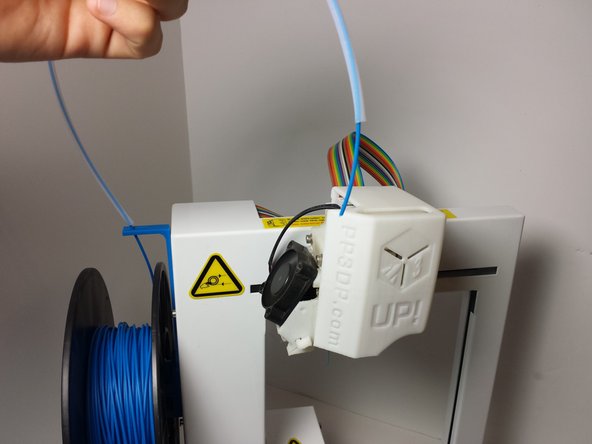

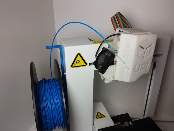

  2. UP! Plus 2 Spool Holder Replacement, Remove plastic filaments: crwdns2935265:02crwdnd2935265:01crwdnd2935265:03crwdne2935265:0 UP! Plus 2 Spool Holder Replacement, Remove plastic filaments: crwdns2935265:02crwdnd2935265:02crwdnd2935265:03crwdne2935265:0 UP! Plus 2 Spool Holder Replacement, Remove plastic filaments: crwdns2935265:02crwdnd2935265:03crwdnd2935265:03crwdne2935265:0
    • Go to "Maintenance" and tell the printer to withdraw the plastic filament from the extrusion assembly. Finish removing the filament by pulling upwards.
    • Wait for a "beeping" sound before removing filament.
    • Cut off any damaged plastic from the end of the filament.
    • Remove the plastic filament tube from the spool.

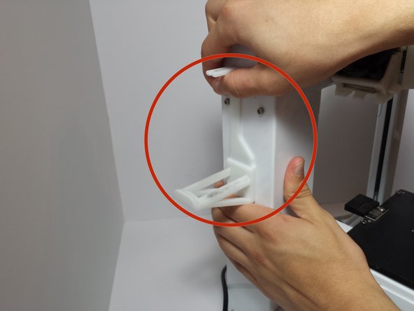

  3. UP! Plus 2 Spool Holder Replacement, Remove spool holder: crwdns2935265:03crwdnd2935265:01crwdnd2935265:03crwdne2935265:0 UP! Plus 2 Spool Holder Replacement, Remove spool holder: crwdns2935265:03crwdnd2935265:02crwdnd2935265:03crwdne2935265:0 UP! Plus 2 Spool Holder Replacement, Remove spool holder: crwdns2935265:03crwdnd2935265:03crwdnd2935265:03crwdne2935265:0
    • Remove the spool from the spool holder by lifting it up and taking it off.
    • Put the end of the filament through the hole on the side of the spool to keep it from unraveling.
    • Slide the spool holder upwards, and then pull outwards.

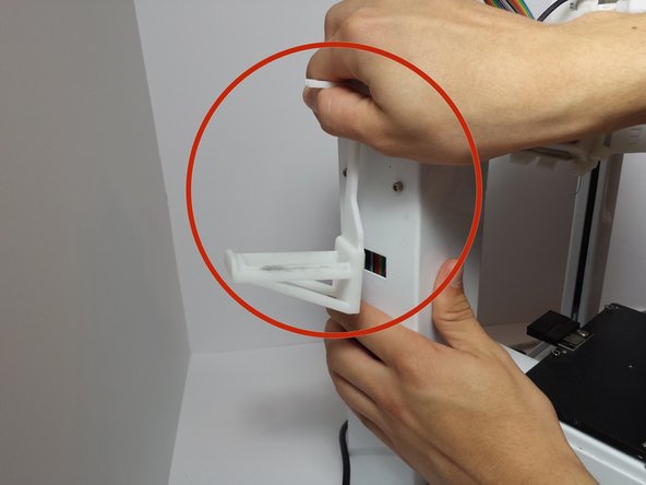

  4. UP! Plus 2 Spool Holder Replacement, Replace spool holder: crwdns2935265:04crwdnd2935265:01crwdnd2935265:03crwdne2935265:0 UP! Plus 2 Spool Holder Replacement, Replace spool holder: crwdns2935265:04crwdnd2935265:02crwdnd2935265:03crwdne2935265:0 UP! Plus 2 Spool Holder Replacement, Replace spool holder: crwdns2935265:04crwdnd2935265:03crwdnd2935265:03crwdne2935265:0
    • Place the new spool holder by pushing it inwards and sliding it down until it locks.
    • Repeat the steps in reverse chronological order to reassemble the printer.
    • The spool should be inserted in way that end of the filament points towards, not away.
