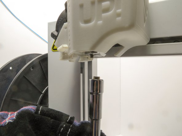

  3. UP! Plus 2 Nozzle Replacement, Remove nozzle: crwdns2935265:03crwdnd2935265:01crwdnd2935265:02crwdne2935265:0 UP! Plus 2 Nozzle Replacement, Remove nozzle: crwdns2935265:03crwdnd2935265:02crwdnd2935265:02crwdne2935265:0
    • The nozzle needs to be greater than 200 degrees Celsius before removal.
    • Before handling the nozzle please put on heat resistant gloves in order to prevent burns.
    • Using the 6mm hex wrench, apply force by pushing up to lock the nozzle into the wrench and turn counterclockwise to loosen the nozzle.
  4. UP! Plus 2 Nozzle Replacement, Attach the new nozzle: crwdns2935265:04crwdnd2935265:01crwdnd2935265:01crwdne2935265:0
    • Before attaching the new nozzle, make sure the temperature is still greater than 200 degrees Celsius.
    • Attach the new nozzle with the hex wrench by screwing it on in a clockwise manner.
    • If there is any extra plastic coming out of the extruder, cut it off before attaching the new nozzle.
