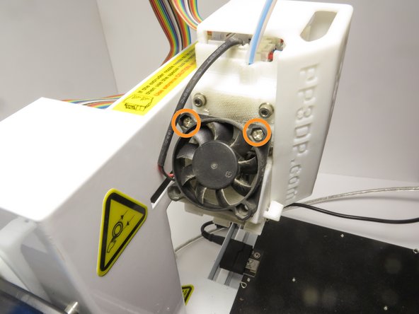

    • Remove the plastic cover that sits on the extruder, next to the fan, by lifting the latches in the back. The latches should lift right out.
  2. UP! Plus 2 Extrusion Head Fan Replacement, Remove fan: crwdns2935265:02crwdnd2935265:01crwdnd2935265:02crwdne2935265:0 UP! Plus 2 Extrusion Head Fan Replacement, Remove fan: crwdns2935265:02crwdnd2935265:02crwdnd2935265:02crwdne2935265:0
    • Using the Phillips #0 screwdriver, locate and remove the two 3mm screws on the top of the fan using a counter-clockwise rotation.

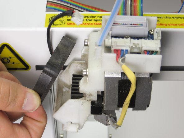

  3. UP! Plus 2 Extrusion Head Fan Replacement: crwdns2935265:03crwdnd2935265:01crwdnd2935265:02crwdne2935265:0 UP! Plus 2 Extrusion Head Fan Replacement: crwdns2935265:03crwdnd2935265:02crwdnd2935265:02crwdne2935265:0
    • Locate the fan connector, a 2-pin JST type, from the extruder board on the top of the extruder assembly and while firmly holding the plastic part of the connector, wiggle out the wire.
    • Gently lift the fan off and away from the module. The fan should easily fall out.
  4. UP! Plus 2 Extrusion Head Fan Replacement, Insert replacement fan: crwdns2935265:04crwdnd2935265:01crwdnd2935265:02crwdne2935265:0 UP! Plus 2 Extrusion Head Fan Replacement, Insert replacement fan: crwdns2935265:04crwdnd2935265:02crwdnd2935265:02crwdne2935265:0
    • Place the replacement fan on the extruder assembly in the right orientation.
    • Connect the cable make sure that it has a solid connection.
    • The fins of the fan should be directed to blow torwards the hot extruder shown in the picture, not away.
    • Secure the fan by screwing the top screws back into place in a clockwise rotation.
    • Finish by putting the plastic top back on.
