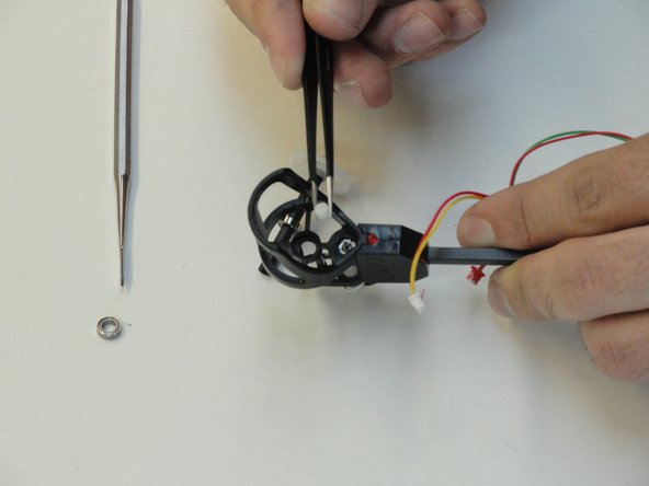

  9. UDI U818A Carbon Tube and Tooth Gears Replacement, Carbon Tube and Tooth Gears: crwdns2935265:09crwdnd2935265:01crwdnd2935265:01crwdne2935265:0
    • Use a pair of tweezers to remove the silver nut from the bottom of the carbon tube.
  10. UDI U818A Carbon Tube and Tooth Gears Replacement: crwdns2935265:010crwdnd2935265:01crwdnd2935265:01crwdne2935265:0
    • Once the ball-bearing is removed, use tweezers and remove the entire tube and gear from the drone arm assembly.
  11. UDI U818A Carbon Tube and Tooth Gears Replacement: crwdns2935265:011crwdnd2935265:01crwdnd2935265:02crwdne2935265:0 UDI U818A Carbon Tube and Tooth Gears Replacement: crwdns2935265:011crwdnd2935265:02crwdnd2935265:02crwdne2935265:0
    • If the tooth gear attached to your carbon tube is the only gear damaged/stripped, then you need not continue.
    • However, if your smaller gear is damaged/stripped as well, then you will need lightly pry it free from the metal post it sits on using a spudger.
    • Once it is free, take your tweezers and remove it completely from the drone arm assembly.
