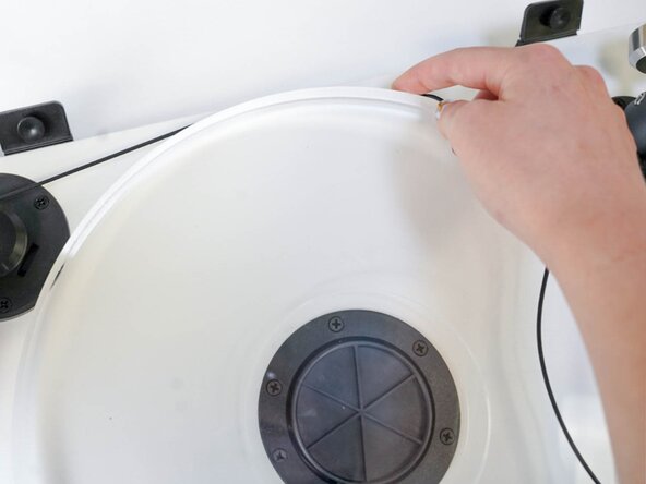

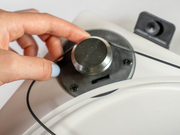

    • Using your left hand, hold the belt in the groove located in the pulley in the upper left hand corner of the turntable.
  2. U-Turn Audio Orbit Drive Belt Replacement: crwdns2935265:02crwdnd2935265:01crwdnd2935265:01crwdne2935265:0
    • Use your right hand to hold the belt against the outer edge of the platter at roughly the 12 o'clock position.

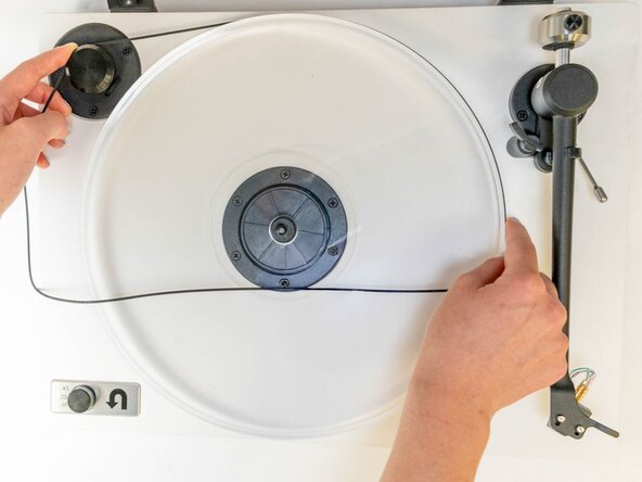

  3. U-Turn Audio Orbit Drive Belt Replacement: crwdns2935265:03crwdnd2935265:01crwdnd2935265:01crwdne2935265:0
    • Rotate the platter to begin wrapping the belt.
    • As you rotate, let the belt slide between your left hand and the pulley notch to easily pull the belt through the pulley.

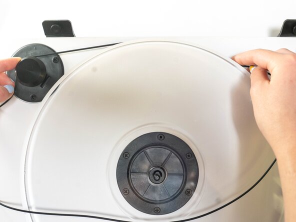

  4. U-Turn Audio Orbit Drive Belt Replacement: crwdns2935265:04crwdnd2935265:01crwdnd2935265:01crwdne2935265:0
    • Continue to rotate the platter while still holding the belt in place with your left until the belt is fully wrapped around the platter.
    • Avoid pulling the pulley or the belt to the right which will lead to excess slack and may cause the belt to fall off the platter.

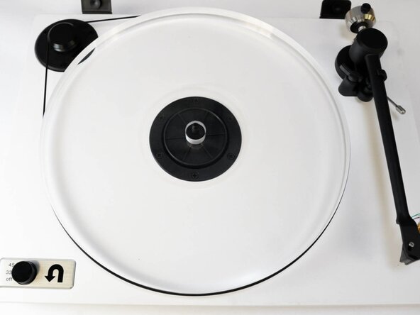

  5. U-Turn Audio Orbit Drive Belt Replacement: crwdns2935265:05crwdnd2935265:01crwdnd2935265:01crwdne2935265:0
    • Once the belt is secured along the entire circumference of the platter, the replacement is complete, and the turnable is once more operational.
