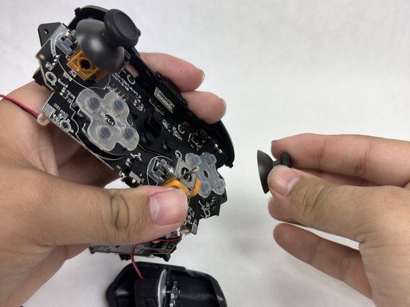

      • Use a Phillips #00 screwdriver to remove seven 10 mm screws from the back plate.
      • When replacing the screws, ensure that the screwdriver is perpendicular to the screw in curved areas.
    2. Turtle Beach Recon Controller Joystick Caps Replacement: crwdns2935265:02crwdnd2935265:01crwdnd2935265:03crwdne2935265:0 Turtle Beach Recon Controller Joystick Caps Replacement: crwdns2935265:02crwdnd2935265:02crwdnd2935265:03crwdne2935265:0 Turtle Beach Recon Controller Joystick Caps Replacement: crwdns2935265:02crwdnd2935265:03crwdnd2935265:03crwdne2935265:0
      • Use an opening tool to separate the back plate from the grips of your Turtle Beach Recon.
      • Use your fingers to remove the back plate from the body of your Turtle Beach Recon.
    1. Turtle Beach Recon Controller Joystick Caps Replacement, Face Plate: crwdns2935265:03crwdnd2935265:01crwdnd2935265:02crwdne2935265:0 Turtle Beach Recon Controller Joystick Caps Replacement, Face Plate: crwdns2935265:03crwdnd2935265:02crwdnd2935265:02crwdne2935265:0
      • Remove the four 10 mm screws from the motherboard using a Phillips #00 screwdriver.
    2. Turtle Beach Recon Controller Joystick Caps Replacement: crwdns2935265:04crwdnd2935265:01crwdnd2935265:02crwdne2935265:0 Turtle Beach Recon Controller Joystick Caps Replacement: crwdns2935265:04crwdnd2935265:02crwdnd2935265:02crwdne2935265:0
      • Use your fingers to grab the motherboard.
      • Gently pull the motherboard and joystick caps away from the face plate.
    3. Turtle Beach Recon Controller Joystick Caps Replacement: crwdns2935265:05crwdnd2935265:01crwdnd2935265:03crwdne2935265:0 Turtle Beach Recon Controller Joystick Caps Replacement: crwdns2935265:05crwdnd2935265:02crwdnd2935265:03crwdne2935265:0 Turtle Beach Recon Controller Joystick Caps Replacement: crwdns2935265:05crwdnd2935265:03crwdnd2935265:03crwdne2935265:0
      • Use a Phillips #00 screwdriver to remove six 10 mm screws from the motherboard.
    1. Turtle Beach Recon Controller Joystick Caps Replacement, Joystick Caps: crwdns2935265:06crwdnd2935265:01crwdnd2935265:02crwdne2935265:0 Turtle Beach Recon Controller Joystick Caps Replacement, Joystick Caps: crwdns2935265:06crwdnd2935265:02crwdnd2935265:02crwdne2935265:0
      • Use your fingers to lift both of the joystick caps off of the motherboard.
      • Remove the joystick caps.
