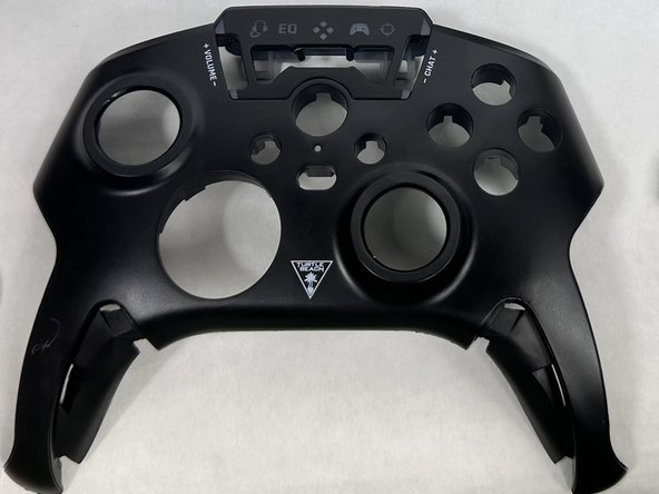

    1. Turtle Beach Recon Controller Front Buttons Replacement, Face Plate: crwdns2935265:03crwdnd2935265:01crwdnd2935265:02crwdne2935265:0 Turtle Beach Recon Controller Front Buttons Replacement, Face Plate: crwdns2935265:03crwdnd2935265:02crwdnd2935265:02crwdne2935265:0
      • Remove the four 10 mm screws from the motherboard using a Phillips #00 screwdriver.
    2. Turtle Beach Recon Controller Front Buttons Replacement: crwdns2935265:04crwdnd2935265:01crwdnd2935265:02crwdne2935265:0 Turtle Beach Recon Controller Front Buttons Replacement: crwdns2935265:04crwdnd2935265:02crwdnd2935265:02crwdne2935265:0
      • Use your fingers to grab the motherboard.
      • Gently pull the motherboard and joystick caps away from the face plate.

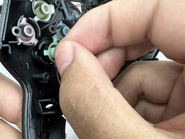

    1. Turtle Beach Recon Controller Front Buttons Replacement, Front Buttons: crwdns2935265:06crwdnd2935265:01crwdnd2935265:03crwdne2935265:0 Turtle Beach Recon Controller Front Buttons Replacement, Front Buttons: crwdns2935265:06crwdnd2935265:02crwdnd2935265:03crwdne2935265:0 Turtle Beach Recon Controller Front Buttons Replacement, Front Buttons: crwdns2935265:06crwdnd2935265:03crwdnd2935265:03crwdne2935265:0
      • Gently remove front buttons from the face plate by hand.
