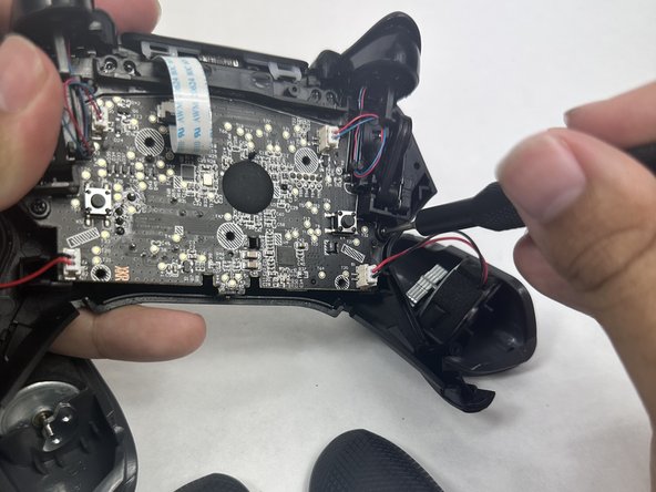

  2. Turtle Beach Recon Controller Face Plate Replacement: crwdns2935265:02crwdnd2935265:01crwdnd2935265:03crwdne2935265:0 Turtle Beach Recon Controller Face Plate Replacement: crwdns2935265:02crwdnd2935265:02crwdnd2935265:03crwdne2935265:0 Turtle Beach Recon Controller Face Plate Replacement: crwdns2935265:02crwdnd2935265:03crwdnd2935265:03crwdne2935265:0
    • Use an opening tool to separate the back plate from the grips of your Turtle Beach Recon.
    • Use your fingers to remove the back plate from the body of your Turtle Beach Recon.

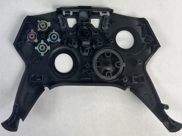

  3. Turtle Beach Recon Controller Face Plate Replacement, Face Plate: crwdns2935265:03crwdnd2935265:01crwdnd2935265:02crwdne2935265:0 Turtle Beach Recon Controller Face Plate Replacement, Face Plate: crwdns2935265:03crwdnd2935265:02crwdnd2935265:02crwdne2935265:0
    • Remove the four 10 mm screws from the motherboard using a Phillips #00 screwdriver.

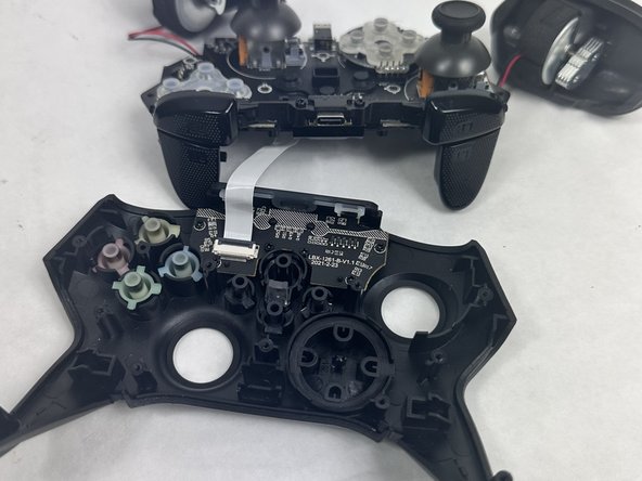

  4. Turtle Beach Recon Controller Face Plate Replacement: crwdns2935265:04crwdnd2935265:01crwdnd2935265:02crwdne2935265:0 Turtle Beach Recon Controller Face Plate Replacement: crwdns2935265:04crwdnd2935265:02crwdnd2935265:02crwdne2935265:0
    • Use your fingers to grab the motherboard.
    • Gently pull the motherboard and joystick caps away from the face plate.

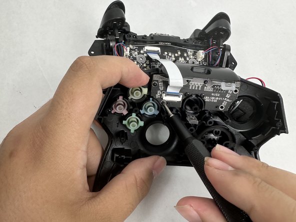

  5. Turtle Beach Recon Controller Face Plate Replacement: crwdns2935265:05crwdnd2935265:01crwdnd2935265:03crwdne2935265:0 Turtle Beach Recon Controller Face Plate Replacement: crwdns2935265:05crwdnd2935265:02crwdnd2935265:03crwdne2935265:0 Turtle Beach Recon Controller Face Plate Replacement: crwdns2935265:05crwdnd2935265:03crwdnd2935265:03crwdne2935265:0
    • Use a Phillips #00 screwdriver to remove six 10 mm screws from the motherboard.
