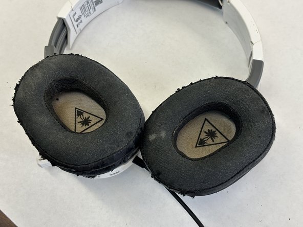

    • Before you begin, power off your headset and unplug it from the charging cable.
    • Place the headset on a flat surface.
    • Grab the outer layer of the cushion and gently pull each ear cup off the headset.

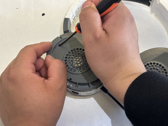

  2. Turtle Beach Recon 200 Gen 2 Audio Repair: crwdns2935265:02crwdnd2935265:01crwdnd2935265:03crwdne2935265:0 Turtle Beach Recon 200 Gen 2 Audio Repair: crwdns2935265:02crwdnd2935265:02crwdnd2935265:03crwdne2935265:0 Turtle Beach Recon 200 Gen 2 Audio Repair: crwdns2935265:02crwdnd2935265:03crwdnd2935265:03crwdne2935265:0
    • Use a Phillips #0 screwdriver to remove three screws from each speaker cover.
    • Use proper screwdriver practices. If you strip a screw, review this guide for tips on how to remove a stripped screw.
    • Place the screws in a secure area. You will need them for reassembly.

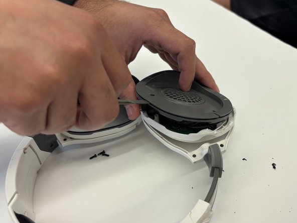

  3. Turtle Beach Recon 200 Gen 2 Audio Repair: crwdns2935265:03crwdnd2935265:01crwdnd2935265:03crwdne2935265:0 Turtle Beach Recon 200 Gen 2 Audio Repair: crwdns2935265:03crwdnd2935265:02crwdnd2935265:03crwdne2935265:0 Turtle Beach Recon 200 Gen 2 Audio Repair: crwdns2935265:03crwdnd2935265:03crwdnd2935265:03crwdne2935265:0
    • Use a spudger to gently pry the speakers from the headset.
    • The speaker is connected to the motherboard by a cable so do not pull the speaker off or it will rip the wire and further damage your headphones.
    • Do not push the prying tool inside the cups, or you could damage the internal components.

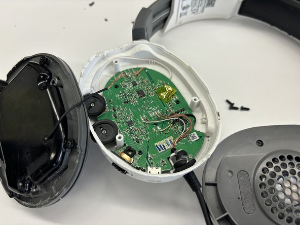

  4. Turtle Beach Recon 200 Gen 2 Audio Repair: crwdns2935265:04crwdnd2935265:01crwdnd2935265:02crwdne2935265:0 Turtle Beach Recon 200 Gen 2 Audio Repair: crwdns2935265:04crwdnd2935265:02crwdnd2935265:02crwdne2935265:0
    • Set the speaker to the side without pulling the wires or cables.
    • Check if any dust has gotten into the headset.
    • If so, use a dust blower and/or ESD safe cleaning brush to clean off the dust.
    • If a wire is broken or ripped, use tweezers to hold it and identity where the wire is meant to be.
    • Do not attempt to rip or pull any damaged or exposed wire(s).

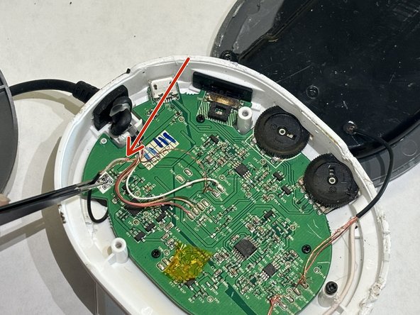

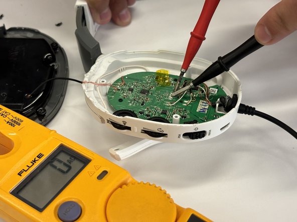

  5. Turtle Beach Recon 200 Gen 2 Audio Repair: crwdns2935265:05crwdnd2935265:01crwdnd2935265:02crwdne2935265:0 Turtle Beach Recon 200 Gen 2 Audio Repair: crwdns2935265:05crwdnd2935265:02crwdnd2935265:02crwdne2935265:0
    • Use the multimeter to check for any outage or shortage of current.
    • Check any and every wire and pins you think are faulty that could be the cause of the issue.
    • Most multimeter devices have sharp points, be careful when checking for current. Touch the surface as lightly as possible.

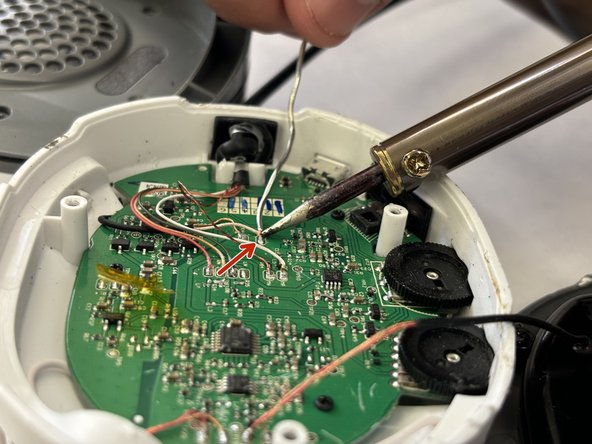

  6. Turtle Beach Recon 200 Gen 2 Audio Repair: crwdns2935265:06crwdnd2935265:01crwdnd2935265:02crwdne2935265:0 Turtle Beach Recon 200 Gen 2 Audio Repair: crwdns2935265:06crwdnd2935265:02crwdnd2935265:02crwdne2935265:0
    • Use a soldering iron to re-solder any wires that have detached from the motherboard.
    • Keep your hands as steady as possible and ensure that the wires are attached to the correct solder joint.
    • The solder might release an odd smell. If possible, wear a mask to avoid inhaling fumes.
    • The end point of the soldering kit will be very hot, do not touch it with your bare hands.
