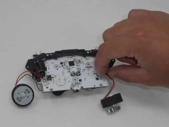

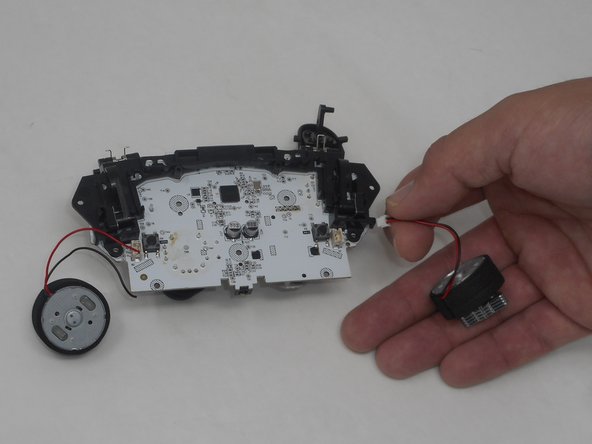

    1. Turtle Beach REACT-R Vibration Motors Replacement, Vibration Motors: crwdns2935265:03crwdnd2935265:01crwdnd2935265:03crwdne2935265:0 Turtle Beach REACT-R Vibration Motors Replacement, Vibration Motors: crwdns2935265:03crwdnd2935265:02crwdnd2935265:03crwdne2935265:0 Turtle Beach REACT-R Vibration Motors Replacement, Vibration Motors: crwdns2935265:03crwdnd2935265:03crwdnd2935265:03crwdne2935265:0
      • Be careful not to damage the vibration motors by dangling the wires.
      • Place the motherboard down on its back.
      • Grip white rumble motor connector and pull it directly out of its socket to disconnect it from the motherboard. Repeat for the other motor.
