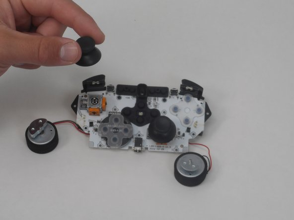

  2. Turtle Beach REACT-R Joystick Covers Replacement, Motherboard: crwdns2935265:02crwdnd2935265:01crwdnd2935265:03crwdne2935265:0 Turtle Beach REACT-R Joystick Covers Replacement, Motherboard: crwdns2935265:02crwdnd2935265:02crwdnd2935265:03crwdne2935265:0 Turtle Beach REACT-R Joystick Covers Replacement, Motherboard: crwdns2935265:02crwdnd2935265:03crwdnd2935265:03crwdne2935265:0
    • Use a Phillips #00 to remove the four 9.2 mm screws that secure the motherboard.
    • Two of the screws are hidden under the red and black vibration motor wires.
    • Gently lift the motherboard up and out of the chassis.
    • Be careful not to strain the vibration motor wires.

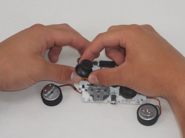

  3. Turtle Beach REACT-R Joystick Covers Replacement, Joystick Covers: crwdns2935265:03crwdnd2935265:01crwdnd2935265:03crwdne2935265:0 Turtle Beach REACT-R Joystick Covers Replacement, Joystick Covers: crwdns2935265:03crwdnd2935265:02crwdnd2935265:03crwdne2935265:0 Turtle Beach REACT-R Joystick Covers Replacement, Joystick Covers: crwdns2935265:03crwdnd2935265:03crwdnd2935265:03crwdne2935265:0
    • Gently twist off each thumb stick, using one hand to secure the base, and the other to twist off the thumb stick.
