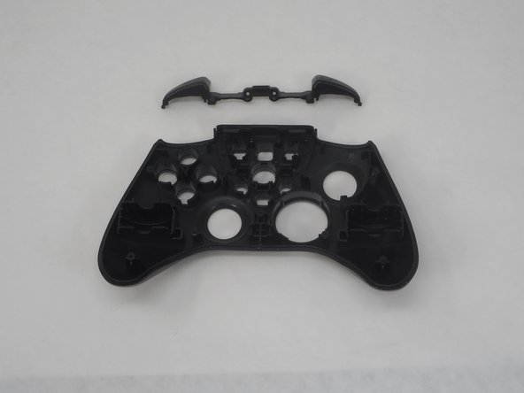

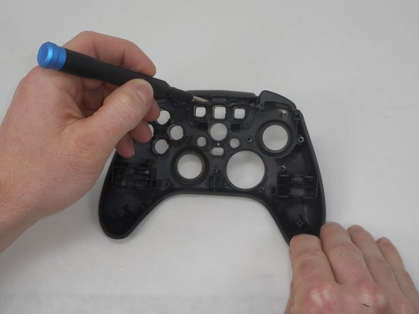

    1. Turtle Beach REACT-R Bumpers Replacement, Bumpers: crwdns2935265:03crwdnd2935265:01crwdnd2935265:03crwdne2935265:0 Turtle Beach REACT-R Bumpers Replacement, Bumpers: crwdns2935265:03crwdnd2935265:02crwdnd2935265:03crwdne2935265:0 Turtle Beach REACT-R Bumpers Replacement, Bumpers: crwdns2935265:03crwdnd2935265:03crwdnd2935265:03crwdne2935265:0
      • Use a Phillips screwdriver to remove the two 9.2 mm screws that secure the right and left bumpers to the face plate.
      • Gently remove each bumper from the faceplate.
