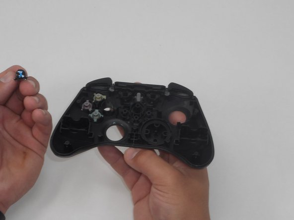

    1. Turtle Beach REACT-R ABXY Buttons Replacement, ABXY Buttons: crwdns2935265:03crwdnd2935265:01crwdnd2935265:02crwdne2935265:0 Turtle Beach REACT-R ABXY Buttons Replacement, ABXY Buttons: crwdns2935265:03crwdnd2935265:02crwdnd2935265:02crwdne2935265:0
      • With the motherboard removed from the face plate, the buttons will be exposed from the inside.
      • The buttons are no longer secure and may fall out. To avoid this, make sure the controller is face down.
      • Gently remove the ABXY buttons.
