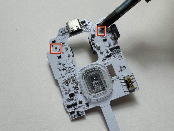

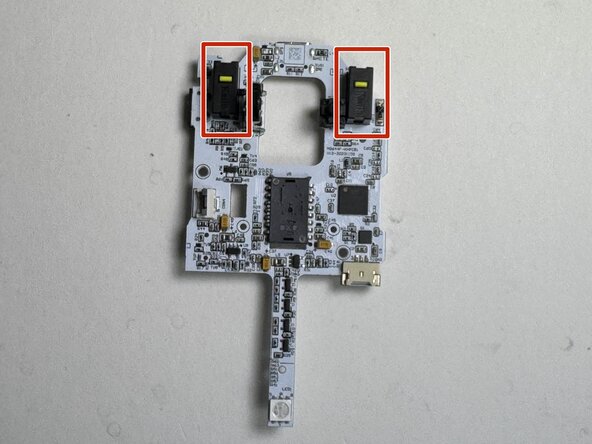

  9. Turtle Beach Pure Air Button Microswitch Replacement, Button Microswitch: crwdns2935265:09crwdnd2935265:01crwdnd2935265:02crwdne2935265:0 Turtle Beach Pure Air Button Microswitch Replacement, Button Microswitch: crwdns2935265:09crwdnd2935265:02crwdnd2935265:02crwdne2935265:0
    • Carefully lift the motherboard to expose the rear side of the board, including the microswitch solder joints.
    • Desolder the solder joints of the microswitch.
This guide is rated Moderate for disassembly. Replacing the microswitch itself requires soldering and is recommended only for users with advanced repair experience.To reassemble your device, follow these instructions in reverse order.
