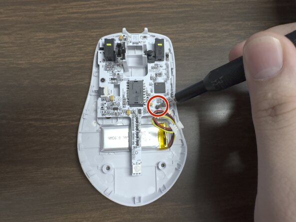

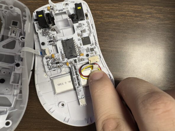

    1. Turtle Beach Pure Air Battery Replacement, Motherboard: crwdns2935265:05crwdnd2935265:01crwdnd2935265:03crwdne2935265:0 Turtle Beach Pure Air Battery Replacement, Motherboard: crwdns2935265:05crwdnd2935265:02crwdnd2935265:03crwdne2935265:0 Turtle Beach Pure Air Battery Replacement, Motherboard: crwdns2935265:05crwdnd2935265:03crwdnd2935265:03crwdne2935265:0
      • Carefully disconnect the battery clip from the motherboard socket by softly pulling the bottom of the clip.
