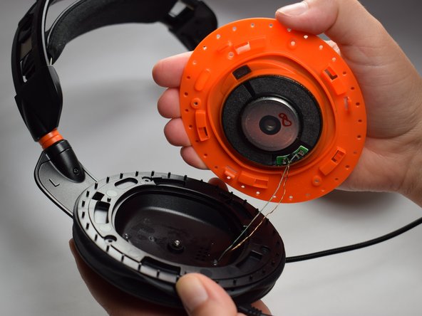

    • Using the Phillips #0 screwdriver, remove the 6.0 mm screws on the orange plate.
  6. Turtle Beach Elite Pro Left Speaker  Replacement: crwdns2935265:06crwdnd2935265:01crwdnd2935265:02crwdne2935265:0 Turtle Beach Elite Pro Left Speaker  Replacement: crwdns2935265:06crwdnd2935265:02crwdnd2935265:02crwdne2935265:0

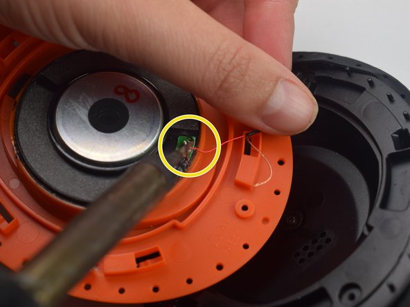

    • Use the opening tool to separate the orange plate from the black base plate.
    • Focus on the wires that are connected to the speaker.
  7. Turtle Beach Elite Pro Left Speaker  Replacement: crwdns2935265:07crwdnd2935265:01crwdnd2935265:01crwdne2935265:0
    • Using wire cutters, cut the two wires that are attached to the speaker.
    • Make sure to cut the wires as close to the speaker as possible, because these wires will be used in the next step.
  8. Turtle Beach Elite Pro Left Speaker  Replacement: crwdns2935265:08crwdnd2935265:01crwdnd2935265:02crwdne2935265:0 Turtle Beach Elite Pro Left Speaker  Replacement: crwdns2935265:08crwdnd2935265:02crwdnd2935265:02crwdne2935265:0
    • Replace the old speaker with the new speaker.
    • Using the soldering iron, solder the wires to the new speaker.
    • Make sure to solder the wires to their original locations on the speaker.
