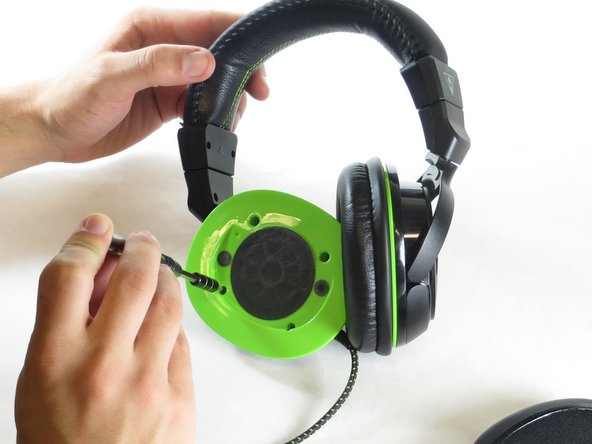

    • Begin by placing your thumb on the plastic edge around the ear pad.
    • Get a good grip around the ear pad and gently separate it from the headset.
    • Apply the same instructions to remove the other foam pad off of the headset.
    • Make sure you continue to gently peel the ear pad from the headset until completely removed.
  2. Turtle Beach Ear Force XO Seven Speaker Cone Replacement, Speaker Cone: crwdns2935265:03crwdnd2935265:01crwdnd2935265:02crwdne2935265:0 Turtle Beach Ear Force XO Seven Speaker Cone Replacement, Speaker Cone: crwdns2935265:03crwdnd2935265:02crwdnd2935265:02crwdne2935265:0
    • A new speaker cone for these headphones will cost about $8 to $10 from amazon.com.
    • After removing the ear pads, unscrew the four Phillips head screws that hold the front plate on.
    • To avoid losing small screws, place them in a container.

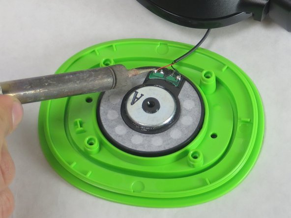

    • When removing the speaker cone plate, be careful not to drop it or put stress on the wires as they are very delicate.
    • Remove the speaker cone plate on a flat surface to prevent unnecessary stress on the wires.
    • The speaker cone is attached to the front plate. To replace, unsolder the wires from the two connection points.
  4. Turtle Beach Ear Force XO Seven Speaker Cone Replacement: crwdns2935265:05crwdnd2935265:01crwdnd2935265:01crwdne2935265:0
    • Replace the speaker cone carefully in place of the old one.
    • Consider tinning the wires before soldering them on to the new speaker cone.
    • Solder the wires back on to the new speaker cone.
    • Reassemble the front plate.
