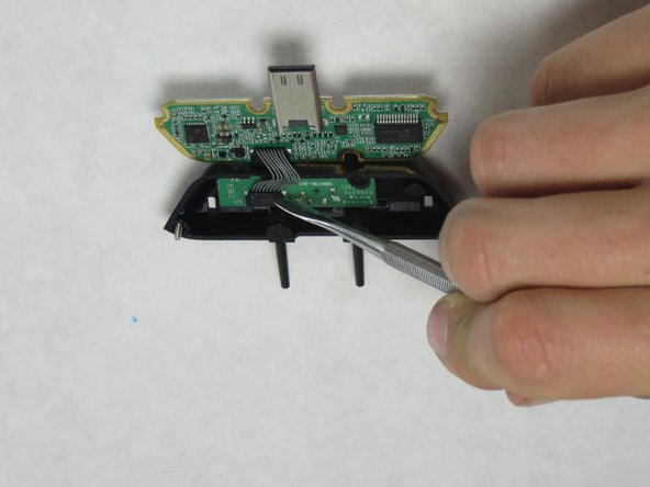

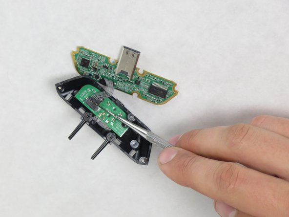

    • Handle with care. The wires and the traces on the circuit board break easily.
    • Insert the sharp end of the Metal Spudger in between the male and the female ends of the nine pin connector and slowly work the ends apart.
  5. Turtle Beach Ear Force XO Seven Adapter Audio Jack Board Replacement: crwdns2935265:05crwdnd2935265:01crwdnd2935265:01crwdne2935265:0
    Phillips #0 Screwdriver
    $5.49
    • Remove the two Phillips #0 head screws on either side of the Audio Jack board. These screws are 5.5 mm in length.
    • Remove the Audio Jack Board.
