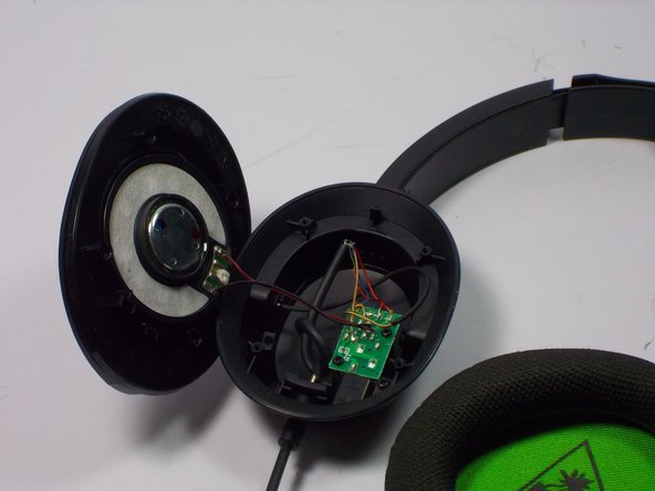

    • Start with the ear padding facing up.
  2. Turtle Beach Ear Force XO One Speaker Replacement: crwdns2935265:02crwdnd2935265:01crwdnd2935265:03crwdne2935265:0 Turtle Beach Ear Force XO One Speaker Replacement: crwdns2935265:02crwdnd2935265:02crwdnd2935265:03crwdne2935265:0 Turtle Beach Ear Force XO One Speaker Replacement: crwdns2935265:02crwdnd2935265:03crwdnd2935265:03crwdne2935265:0
    • Remove the ear padding by separating the fabric piece from the plastic headphone piece.
    • The leather padding will slide off the plastic piece holding it in place. Don't be afraid to pull with a little force.
  3. Turtle Beach Ear Force XO One Speaker Replacement: crwdns2935265:03crwdnd2935265:01crwdnd2935265:02crwdne2935265:0 Turtle Beach Ear Force XO One Speaker Replacement: crwdns2935265:03crwdnd2935265:02crwdnd2935265:02crwdne2935265:0
    • Use a Philips head screwdriver to remove the speaker cover.
    • Be careful the speaker is attached to the chip inside by wires.
    • The recommended screwdriver bit size is a PH 0.
    • Once the speaker cover is removed, the wires can be cut or de-soldered.
    • Remove the speaker.
    • Insert the new speaker
