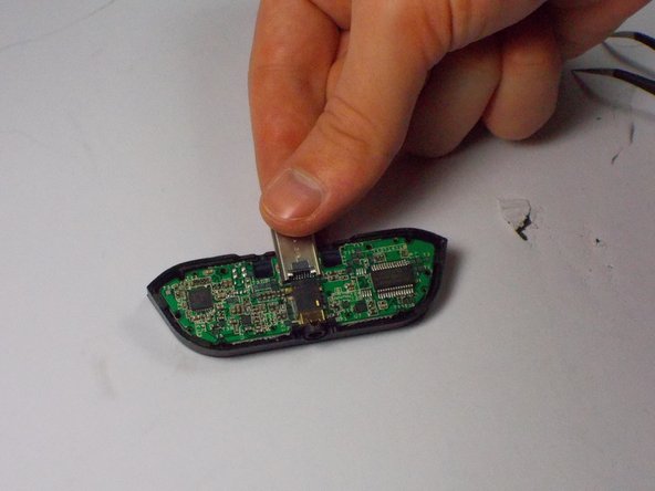

  3. Turtle Beach Ear Force XO One Adapter Buttons Replacement: crwdns2935265:03crwdnd2935265:01crwdnd2935265:03crwdne2935265:0 Turtle Beach Ear Force XO One Adapter Buttons Replacement: crwdns2935265:03crwdnd2935265:02crwdnd2935265:03crwdne2935265:0 Turtle Beach Ear Force XO One Adapter Buttons Replacement: crwdns2935265:03crwdnd2935265:03crwdnd2935265:03crwdne2935265:0
    • Now, using the same Philips head screwdriver, unscrew the two screws on either side that hold the circuit board to the adapter case.
    • Once the screws are out, you can remove the circuit board from the casing.
  4. Turtle Beach Ear Force XO One Adapter Buttons Replacement: crwdns2935265:04crwdnd2935265:01crwdnd2935265:01crwdne2935265:0
    • Push the rubber piece containing the buttons out of the plastic adapter casing.
    • Then, replace it with a new one.
