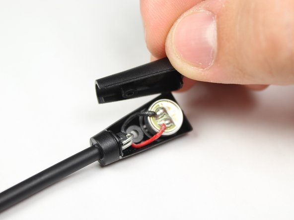

Turtle Beach Ear Force XO Four Microphone Replacement
  1. Turtle Beach Ear Force XO Four Microphone Replacement, Microphone: crwdns2935265:01crwdnd2935265:01crwdnd2935265:03crwdne2935265:0 Turtle Beach Ear Force XO Four Microphone Replacement, Microphone: crwdns2935265:01crwdnd2935265:02crwdnd2935265:03crwdne2935265:0 Turtle Beach Ear Force XO Four Microphone Replacement, Microphone: crwdns2935265:01crwdnd2935265:03crwdnd2935265:03crwdne2935265:0
    • Gently remove the foam pad from the microphone by pulling it apart.
  2. Turtle Beach Ear Force XO Four Microphone Replacement: crwdns2935265:02crwdnd2935265:01crwdnd2935265:01crwdne2935265:0
    • Remove the PH0 7.1 mm screw from the back casing.
  3. Turtle Beach Ear Force XO Four Microphone Replacement: crwdns2935265:03crwdnd2935265:01crwdnd2935265:02crwdne2935265:0 Turtle Beach Ear Force XO Four Microphone Replacement: crwdns2935265:03crwdnd2935265:02crwdnd2935265:02crwdne2935265:0
    • Remove the back casing from the microphone.
    • Desolder the two wires from the back of the microphone. For instructions on soldering, please see iFixit's soldering guide.
