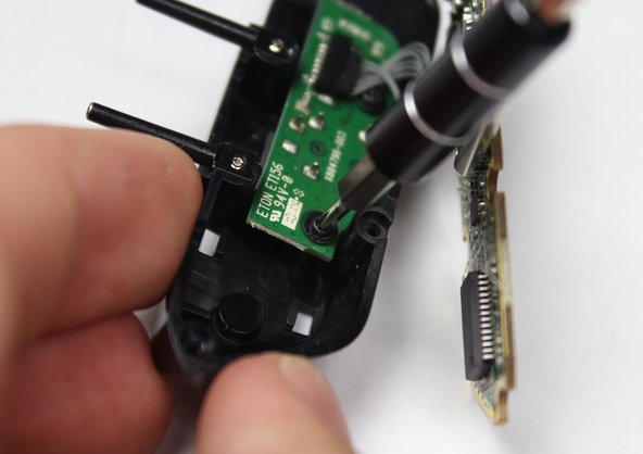

  4. Turtle Beach Ear Force XO Four Audio Adapter Replacement: crwdns2935265:04crwdnd2935265:01crwdnd2935265:02crwdne2935265:0 Turtle Beach Ear Force XO Four Audio Adapter Replacement: crwdns2935265:04crwdnd2935265:02crwdnd2935265:02crwdne2935265:0
    • Remove the two PH000 5.5mm screws from the smaller circuit board.
    • Remove the board.

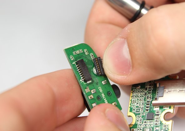

  5. Turtle Beach Ear Force XO Four Audio Adapter Replacement: crwdns2935265:05crwdnd2935265:01crwdnd2935265:02crwdne2935265:0 Turtle Beach Ear Force XO Four Audio Adapter Replacement: crwdns2935265:05crwdnd2935265:02crwdnd2935265:02crwdne2935265:0
    • Detach the wires from the smaller circuit board.
