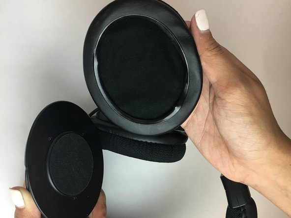

    • Start by removing the left ear pad.
    • Gently pull on the pad from the side by the leathery material until it comes loose from slot.
    • Be careful not to rip the fabric.
  2. Turtle Beach Ear Force X12 Microphone Replacement: crwdns2935265:02crwdnd2935265:01crwdnd2935265:01crwdne2935265:0
    • Grip ear cushion and carefully pull up and separate from the plastic headphone.
  3. Turtle Beach Ear Force X12 Microphone Replacement: crwdns2935265:03crwdnd2935265:01crwdnd2935265:02crwdne2935265:0 Turtle Beach Ear Force X12 Microphone Replacement: crwdns2935265:03crwdnd2935265:02crwdnd2935265:02crwdne2935265:0
    • Your headset should look like the first picture, with the left cushion removed.
    • Repeat these steps for right cushion.
    • You may now continue with more complex inner headset repair, or replace the ear pads by sliding on new ones in the slot.

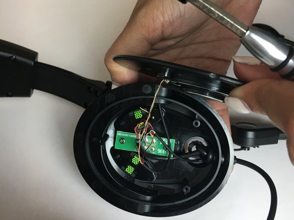

  4. Turtle Beach Ear Force X12 Microphone Replacement, Microphone: crwdns2935265:04crwdnd2935265:01crwdnd2935265:02crwdne2935265:0 Turtle Beach Ear Force X12 Microphone Replacement, Microphone: crwdns2935265:04crwdnd2935265:02crwdnd2935265:02crwdne2935265:0
    • Remove the three 1.1 mm screws around the speaker using a T3 screwdriver.
    • Open the top panel carefully.
    • Potential for device damage: The wires are very delicate and can be broken easily.

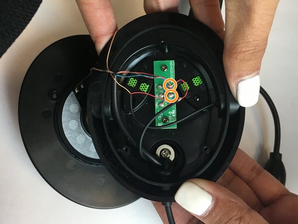

  6. Turtle Beach Ear Force X12 Microphone Replacement: crwdns2935265:06crwdnd2935265:01crwdnd2935265:02crwdne2935265:0 Turtle Beach Ear Force X12 Microphone Replacement: crwdns2935265:06crwdnd2935265:02crwdnd2935265:02crwdne2935265:0
    • Cut the microphone wire with wire cutters.
    • Desolder the microphone wires.
    • Practice caution while soldering. Ensure proper safety and soldering procedure is followed to avoid component damage and injury.
    • For more information on soldering, check out this guide.
  7. Turtle Beach Ear Force X12 Microphone Replacement: crwdns2935265:07crwdnd2935265:01crwdnd2935265:02crwdne2935265:0 Turtle Beach Ear Force X12 Microphone Replacement: crwdns2935265:07crwdnd2935265:02crwdnd2935265:02crwdne2935265:0
    • Insert the new microphone and solder the wires into the correct positions.
    • Position the speaker on the headset so the screw holes are aligned.
