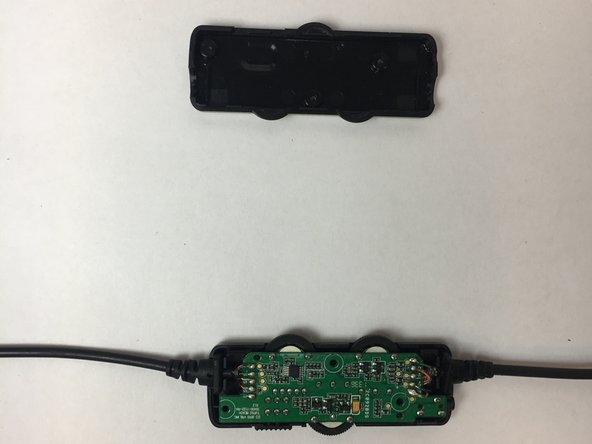

    • Flip the audio jack casing so the screws are facing you.
  2. Turtle Beach Ear Force X12 Audio Jack Case Replacement: crwdns2935265:02crwdnd2935265:01crwdnd2935265:01crwdne2935265:0
    • Remove the three 1.1 mm screws using a Phillips #00 screwdriver.
  3. Turtle Beach Ear Force X12 Audio Jack Case Replacement: crwdns2935265:03crwdnd2935265:01crwdnd2935265:02crwdne2935265:0 Turtle Beach Ear Force X12 Audio Jack Case Replacement: crwdns2935265:03crwdnd2935265:02crwdnd2935265:02crwdne2935265:0
    • Insert a plastic opening tool between the two plastic pieces to pry it open.
  4. Turtle Beach Ear Force X12 Audio Jack Case Replacement: crwdns2935265:04crwdnd2935265:01crwdnd2935265:01crwdne2935265:0
    • Carefully remove the audio board from casing.
