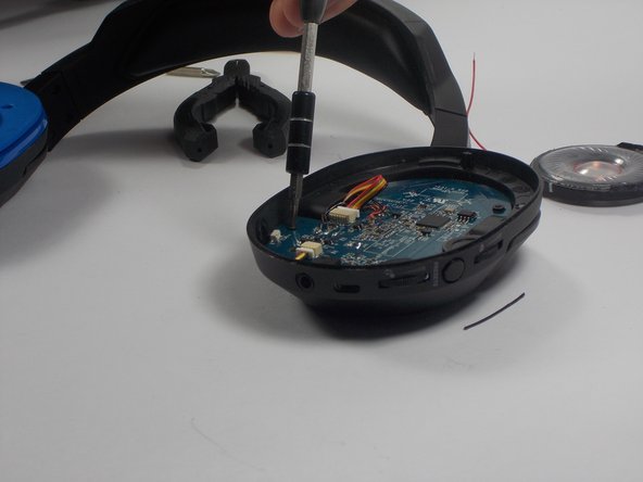

  3. Turtle Beach Ear Force Stealth 500P Battery Replacement, Battery: crwdns2935265:03crwdnd2935265:01crwdnd2935265:03crwdne2935265:0 Turtle Beach Ear Force Stealth 500P Battery Replacement, Battery: crwdns2935265:03crwdnd2935265:02crwdnd2935265:03crwdne2935265:0 Turtle Beach Ear Force Stealth 500P Battery Replacement, Battery: crwdns2935265:03crwdnd2935265:03crwdnd2935265:03crwdne2935265:0
    • Use screwdriver tip J00 to remove three screws fastening circuit board to casing.

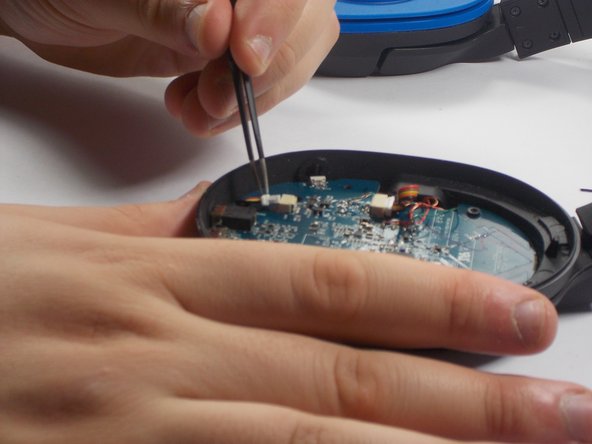

  4. Turtle Beach Ear Force Stealth 500P Battery Replacement: crwdns2935265:04crwdnd2935265:01crwdnd2935265:02crwdne2935265:0 Turtle Beach Ear Force Stealth 500P Battery Replacement: crwdns2935265:04crwdnd2935265:02crwdnd2935265:02crwdne2935265:0
    • Use bent tweezers to remove two wire connector plugs from circuit board.

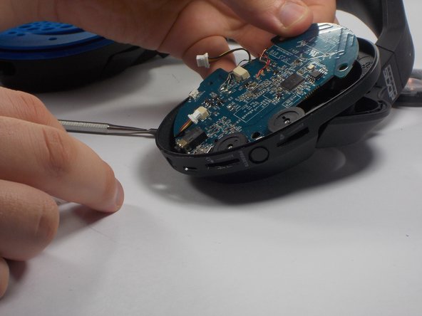

  5. Turtle Beach Ear Force Stealth 500P Battery Replacement: crwdns2935265:05crwdnd2935265:01crwdnd2935265:02crwdne2935265:0 Turtle Beach Ear Force Stealth 500P Battery Replacement: crwdns2935265:05crwdnd2935265:02crwdnd2935265:02crwdne2935265:0
    • Circuit board will be free to be removed by hand. Use plastic pry tool to slide between casing and circuit board if needed.
