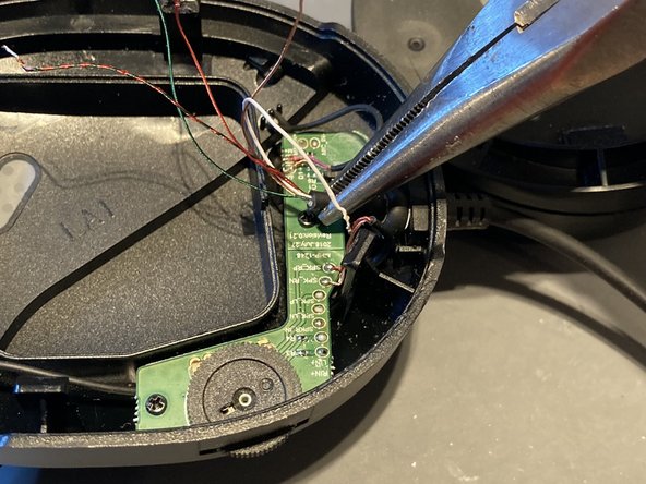

  4. Turtle Beach Atlas One Audio Cable Replacement, De-solder the old wiring: crwdns2935265:04crwdnd2935265:01crwdnd2935265:03crwdne2935265:0 Turtle Beach Atlas One Audio Cable Replacement, De-solder the old wiring: crwdns2935265:04crwdnd2935265:02crwdnd2935265:03crwdne2935265:0 Turtle Beach Atlas One Audio Cable Replacement, De-solder the old wiring: crwdns2935265:04crwdnd2935265:03crwdnd2935265:03crwdne2935265:0
    • Desolder the top 3 connections. RIN+, LIN+, SPKR_IN
    • And the MIN_IN, and mic ground.
    • I removed the left headset too, so it is easier to work with the headset.

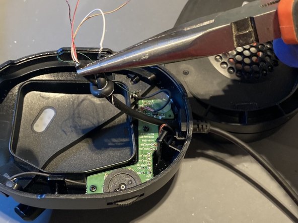

  5. Turtle Beach Atlas One Audio Cable Replacement, Untying the stopper knot: crwdns2935265:05crwdnd2935265:01crwdnd2935265:03crwdne2935265:0 Turtle Beach Atlas One Audio Cable Replacement, Untying the stopper knot: crwdns2935265:05crwdnd2935265:02crwdnd2935265:03crwdne2935265:0 Turtle Beach Atlas One Audio Cable Replacement, Untying the stopper knot: crwdns2935265:05crwdnd2935265:03crwdnd2935265:03crwdne2935265:0
    • Now all the wires should be free.
    • Grab the end of the wire at the knot and pull a bit of slack through so you can untie the knot.
  6. Turtle Beach Atlas One Audio Cable Replacement, Removing the old cable: crwdns2935265:06crwdnd2935265:01crwdnd2935265:02crwdne2935265:0 Turtle Beach Atlas One Audio Cable Replacement, Removing the old cable: crwdns2935265:06crwdnd2935265:02crwdnd2935265:02crwdne2935265:0
    • Simply insert a new cable and re-solder the wires.
    • See the cleaned board for reference for re-soldering.

Hi. Thanks for this guide. Any idea where to obtain the correct replacement cable, and which wires correspond to which positions on the jack plug? Thanks.
Richard Carey - crwdns2934203:0crwdne2934203:0
I bought replacement cable on ebay. Look for 4 core cables (shielded if possible to reduce interference). Just use the continuity setting on your DMM to make sure you connect the new wire back the correct order.
On the ones I fixed the colouring was as below
RIN+ red
LIN+ green
SPKR_IN orange (ground)
MIC_IN+ white
MIC_IN- red+green striped (ground)
If you get a cable with a jack plug already mounted the correct connection from the tip of the jack plug to the cable side is as follows
LIN+
RIN+
SPKR_IN
MIC_IN+
Hope it helps!
honakrisi - crwdns2934203:0crwdne2934203:0
Fantastic - thanks so much for this. I will give it a try.
Perfect thanks. Worked a treat - headphones working again now. Thanks so much.
Glad to hear that! Well done!
