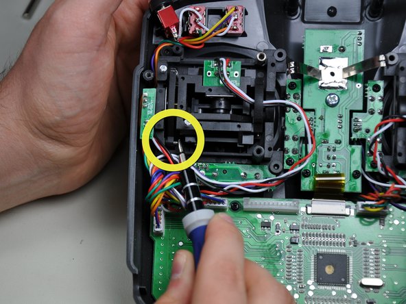

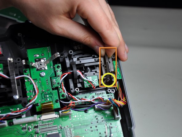

    • Remove the spring arm and spring for the left stick.
    • Push out the retaining pin.
    • Remove the retaining pin and spring arm.
    • Remove the spring.

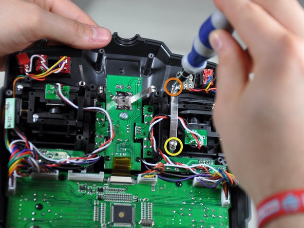

  5. Turnigy 9X Mode 1 to Mode 2 conversion: crwdns2935265:05crwdnd2935265:01crwdnd2935265:01crwdne2935265:0
    • Remove the tensioner from the right stick.

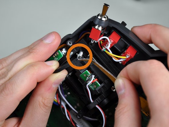

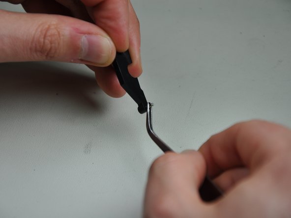

    • Remove the retaining pin from the right stick.
    • Drop the retaining pin into the spring arm. It is a loose fit, so it will freely drop straight through if the arm isn't held level.
  8. Turnigy 9X Mode 1 to Mode 2 conversion: crwdns2935265:08crwdnd2935265:01crwdnd2935265:03crwdne2935265:0 Turnigy 9X Mode 1 to Mode 2 conversion: crwdns2935265:08crwdnd2935265:02crwdnd2935265:03crwdne2935265:0 Turnigy 9X Mode 1 to Mode 2 conversion: crwdns2935265:08crwdnd2935265:03crwdnd2935265:03crwdne2935265:0

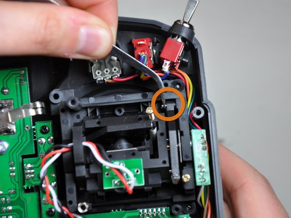

    • Attach the spring to the plastic hook on the right stick.
    • Hook the spring over the end of the spring arm.
    • Line the spring arm up with the hole in the right stick casing and push the pin into place so it is flush with the side of the spring arm.

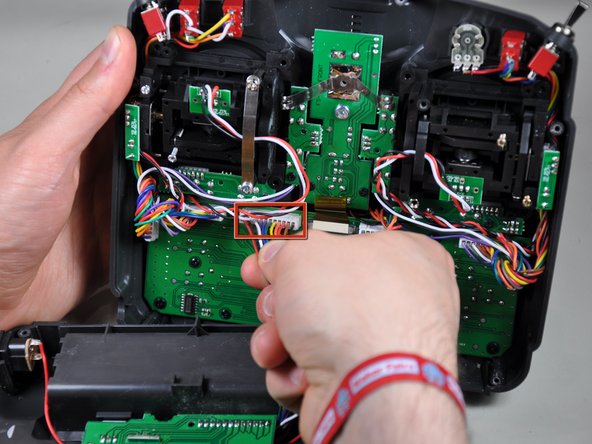

    • Reconnect the cable linking the front and back halves of the transmitter.
    • Close up the case and enjoy your Mode 2 transmitter.

Make sure you hold the spring arm down when you push out the retaining pin. The pin required some force to move and ended up moving all at once causing the spring and spring arm to fly across the room. I almost didn't find them.
