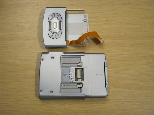

  3. Tungsten T3 Battery Replacement: crwdns2935265:03crwdnd2935265:01crwdnd2935265:03crwdne2935265:0 Tungsten T3 Battery Replacement: crwdns2935265:03crwdnd2935265:02crwdnd2935265:03crwdne2935265:0 Tungsten T3 Battery Replacement: crwdns2935265:03crwdnd2935265:03crwdnd2935265:03crwdne2935265:0
    • Gently remove the function panel from the device.
    • Be careful - it's still connected by the button cable. Peel the cable from the device carefully with a spudger - it is attached with a little bit of adhesive.
    • Carefully remove the connector and set the panel aside.

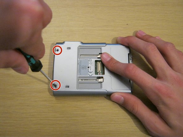

  4. Tungsten T3 Battery Replacement: crwdns2935265:04crwdnd2935265:01crwdnd2935265:02crwdne2935265:0 Tungsten T3 Battery Replacement: crwdns2935265:04crwdnd2935265:02crwdnd2935265:02crwdne2935265:0
    • Remove the two Phillips #00 screws on the back of the device.

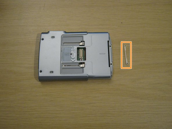

  5. Tungsten T3 Battery Replacement: crwdns2935265:05crwdnd2935265:01crwdnd2935265:03crwdne2935265:0 Tungsten T3 Battery Replacement: crwdns2935265:05crwdnd2935265:02crwdnd2935265:03crwdne2935265:0 Tungsten T3 Battery Replacement: crwdns2935265:05crwdnd2935265:03crwdnd2935265:03crwdne2935265:0
    • Remove the two small Phillips #00 screws at the other end of the device.
    • A small metal part will fall out of the device from the other side. Keep hold of this - you won't be able to put these screws back in without it.

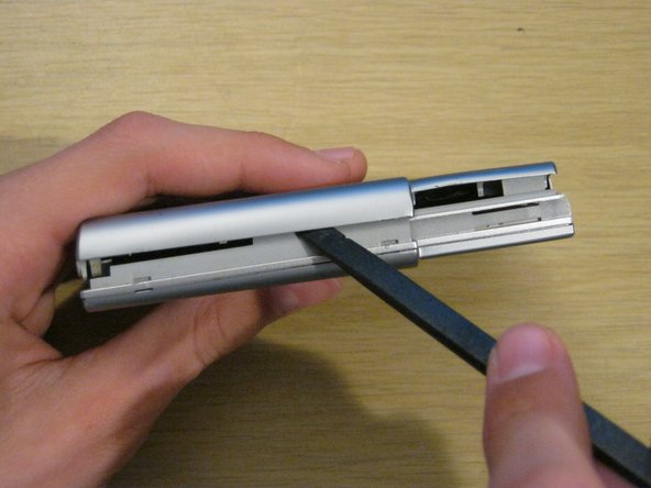

  6. Tungsten T3 Battery Replacement: crwdns2935265:06crwdnd2935265:01crwdnd2935265:03crwdne2935265:0 Tungsten T3 Battery Replacement: crwdns2935265:06crwdnd2935265:02crwdnd2935265:03crwdne2935265:0 Tungsten T3 Battery Replacement: crwdns2935265:06crwdnd2935265:03crwdnd2935265:03crwdne2935265:0
    • Using a spudger, gently separate the back casing from the rest of the device.
    • Be careful - the back casing contains the battery, which is connected by a very thin battery cable.

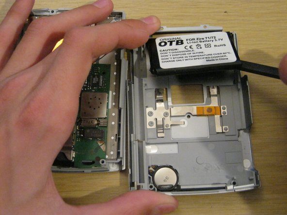

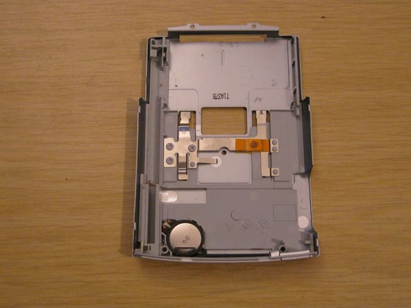

  7. Tungsten T3 Battery Replacement: crwdns2935265:07crwdnd2935265:01crwdnd2935265:03crwdne2935265:0 Tungsten T3 Battery Replacement: crwdns2935265:07crwdnd2935265:02crwdnd2935265:03crwdne2935265:0 Tungsten T3 Battery Replacement: crwdns2935265:07crwdnd2935265:03crwdnd2935265:03crwdne2935265:0
    • Lay the two halves side by side.
    • The battery is usually held to the case by a small amount of adhesive. Carefully peel it up with a spudger.
    • Lay the back case aside.

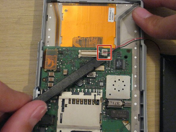

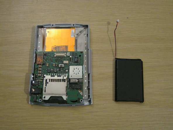

  8. Tungsten T3 Battery Replacement: crwdns2935265:08crwdnd2935265:01crwdnd2935265:03crwdne2935265:0 Tungsten T3 Battery Replacement: crwdns2935265:08crwdnd2935265:02crwdnd2935265:03crwdne2935265:0 Tungsten T3 Battery Replacement: crwdns2935265:08crwdnd2935265:03crwdnd2935265:03crwdne2935265:0
    • You should now be left with the front panel and the battery.
    • Gently disconnect the battery connector from the front panel. It's small and the pins are delicate, so be careful not to bend it.
    • When you install the new battery, you may find it useful to secure it to the back casing with some double-sided tape or even a small amount of glue.

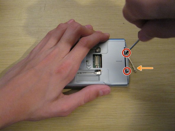

  9. Tungsten T3 Battery Replacement: crwdns2935265:09crwdnd2935265:01crwdnd2935265:02crwdne2935265:0 Tungsten T3 Battery Replacement: crwdns2935265:09crwdnd2935265:02crwdnd2935265:02crwdne2935265:0
    • When reassembling your device, remember to place the small metal part on the front of the device and hold it while you insert the two small screws.
    • The screws won't stay in unless they're screwed into this metal part.

The only thing I would add is before replacing the battery, be sure to backup your device since disconnecting the battery will do a total reset.
