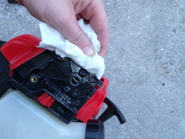

  4. Troy-Bilt TB675 EC Air Filter Replacement: crwdns2935265:04crwdnd2935265:01crwdnd2935265:02crwdne2935265:0 Troy-Bilt TB675 EC Air Filter Replacement: crwdns2935265:04crwdnd2935265:02crwdnd2935265:02crwdne2935265:0
    • Wipe all oil and water residue around the air filter casing with a paper towel or rag.
