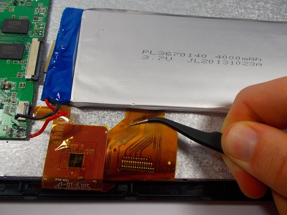

  8. Trio Stealth-10 Motherboard Replacement, Battery: crwdns2935265:08crwdnd2935265:01crwdnd2935265:01crwdne2935265:0
    • This step will require soldering. If you are unfamiliar with soldering then we recommend that you get help from another person or use the soldering guide made by Ifixit to help.
    • Solder the connections off for the battery.
  9. Trio Stealth-10 Motherboard Replacement: crwdns2935265:09crwdnd2935265:01crwdnd2935265:02crwdne2935265:0 Trio Stealth-10 Motherboard Replacement: crwdns2935265:09crwdnd2935265:02crwdnd2935265:02crwdne2935265:0
    • Disconnect the screen/digitizer connection. Use tweezers and pull each grey end of the connection until there is a small gap between the grey and white on the connector to the motherboard. The connection should be easily removable.
    • Pull the cable away and clear from under the battery to avoid damage to the connection.

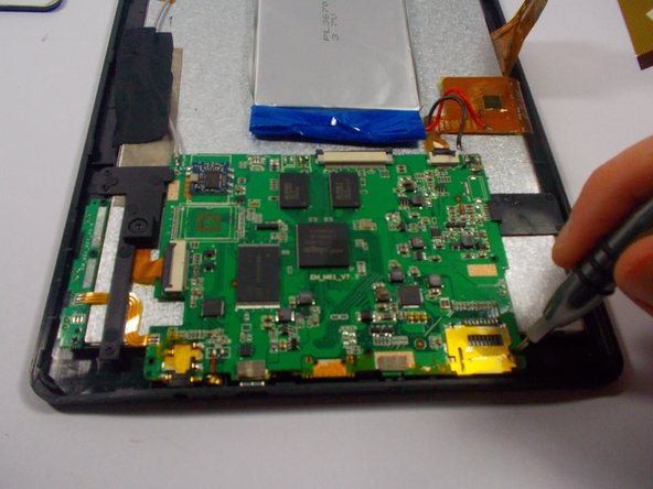

  11. Trio Stealth-10 Motherboard Replacement, Motherboard: crwdns2935265:011crwdnd2935265:01crwdnd2935265:01crwdne2935265:0
    • Use your spudger to disconnect the screen/digitizer connection from the motherboard.
  12. Trio Stealth-10 Motherboard Replacement: crwdns2935265:012crwdnd2935265:01crwdnd2935265:02crwdne2935265:0 Trio Stealth-10 Motherboard Replacement: crwdns2935265:012crwdnd2935265:02crwdnd2935265:02crwdne2935265:0
    • Use a pair of tweezers to grasp the screen/digitizer connection gently and remove each accordingly.
  13. Trio Stealth-10 Motherboard Replacement: crwdns2935265:013crwdnd2935265:01crwdnd2935265:01crwdne2935265:0
    • Grasp the EDC tape with your tweezers and lift it off gently from the motherboard and set aside to be reused.
  14. Trio Stealth-10 Motherboard Replacement: crwdns2935265:014crwdnd2935265:01crwdnd2935265:02crwdne2935265:0 Trio Stealth-10 Motherboard Replacement: crwdns2935265:014crwdnd2935265:02crwdnd2935265:02crwdne2935265:0
    • Use a Phillips #0 to unscrew the 4mm screws from the motherboard fixture.
  15. Trio Stealth-10 Motherboard Replacement: crwdns2935265:015crwdnd2935265:01crwdnd2935265:01crwdne2935265:0
    • Be sure that all the connections to the motherboard are disconnected. Proceed to remove the motherboard by slowly tilting it away from you and then lifting it straight up.
