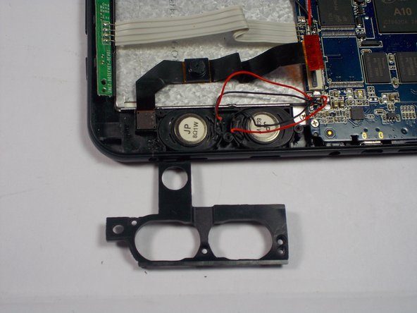

    • Remove 2 black 4 cm screws on either side of the bottom of the device.
  2. Trio Stealth Pro 9.7" Speaker Replacement: crwdns2935265:02crwdnd2935265:01crwdnd2935265:02crwdne2935265:0 Trio Stealth Pro 9.7" Speaker Replacement: crwdns2935265:02crwdnd2935265:02crwdnd2935265:02crwdne2935265:0
    • Use the plastic opening tools and the spudger around the outside of silver metal back plate on the device to pry off the back plate.
  3. Trio Stealth Pro 9.7" Speaker Replacement: crwdns2935265:03crwdnd2935265:01crwdnd2935265:02crwdne2935265:0 Trio Stealth Pro 9.7" Speaker Replacement: crwdns2935265:03crwdnd2935265:02crwdnd2935265:02crwdne2935265:0
    • Remove 3 silver 4 cm Phillips screws holding down plastic speaker cover.
    • Remove plastic cover.
  4. Trio Stealth Pro 9.7" Speaker Replacement: crwdns2935265:04crwdnd2935265:01crwdnd2935265:02crwdne2935265:0 Trio Stealth Pro 9.7" Speaker Replacement: crwdns2935265:04crwdnd2935265:02crwdnd2935265:02crwdne2935265:0
    • Cut 2 red and 2 black wires connecting speakers to the motherboard.
    • Remove speakers.
