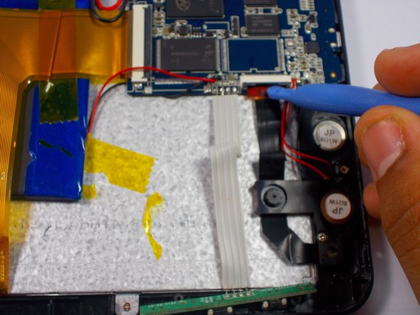

    • Use plastic opening tool to lift up black clip.
    • Gently pull out flex cable.

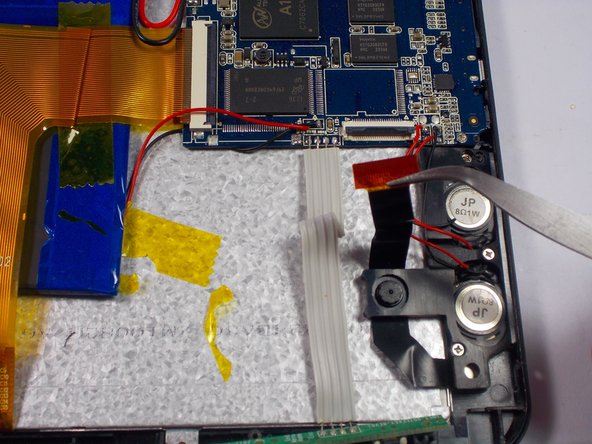

  4. Trio Stealth Pro 9.7" Rear/Front Camera Replacement: crwdns2935265:04crwdnd2935265:01crwdnd2935265:01crwdne2935265:0
    • Remove 3 silver 4 cm Phillips screws holding down black plastic speaker cover.
    • Gently pull up on plastic to uncover clip connected to the camera.
  5. Trio Stealth Pro 9.7" Rear/Front Camera Replacement: crwdns2935265:05crwdnd2935265:01crwdnd2935265:02crwdne2935265:0 Trio Stealth Pro 9.7" Rear/Front Camera Replacement: crwdns2935265:05crwdnd2935265:02crwdnd2935265:02crwdne2935265:0

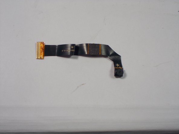

    • Use the tweezers and gently lift up on the clip.
    • Remove the front/rear camera.
