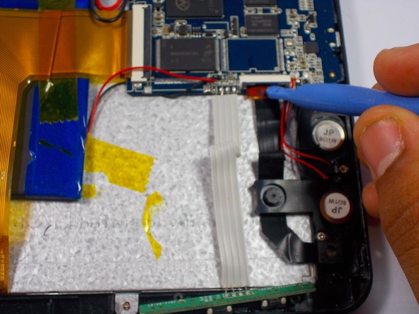

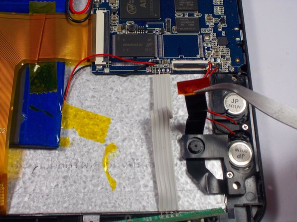

    • Unclip camera flex cable
    • Use plastic opening tool to lift open black clip where the flex cables are attached to the motherboard.
    • Then gently pull out the flex cable with tweezers.

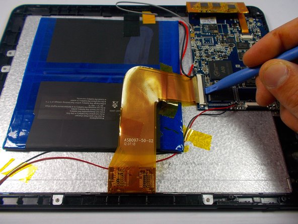

    • Unclip large orange flex cable.

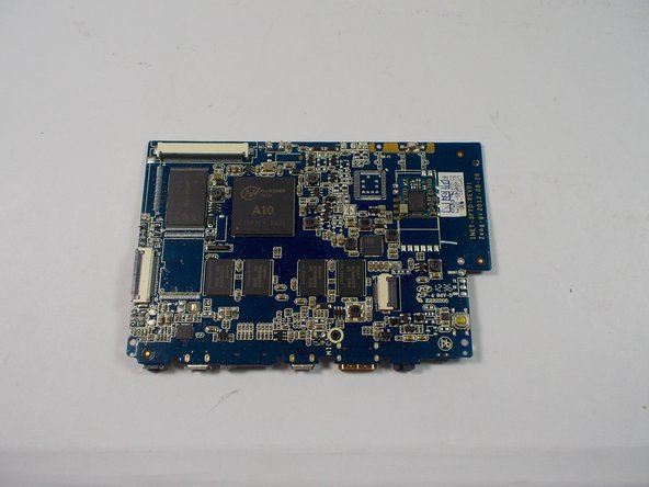

    • Cut 4 wire cable attached to the right side of the motherboard.
    • Remove motherboard.
