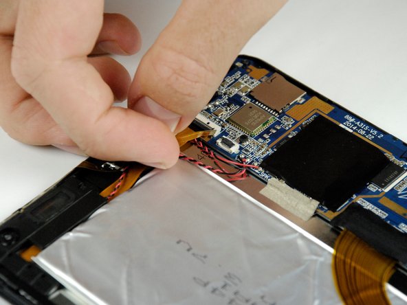

      • Remove the yellow tape covering the set of wires located near the upper right corner of the battery.
    2. Trio Stealth G4 Volume Buttons Replacement: crwdns2935265:07crwdnd2935265:01crwdnd2935265:03crwdne2935265:0 Trio Stealth G4 Volume Buttons Replacement: crwdns2935265:07crwdnd2935265:02crwdnd2935265:03crwdne2935265:0 Trio Stealth G4 Volume Buttons Replacement: crwdns2935265:07crwdnd2935265:03crwdnd2935265:03crwdne2935265:0
      • Wedge a spudger underneath the black flap on the zero insertion force (ZIF) connector and flip it up.
      • Once the flap is up, use your fingers to disconnect the end of the ribbon wire from the connector.

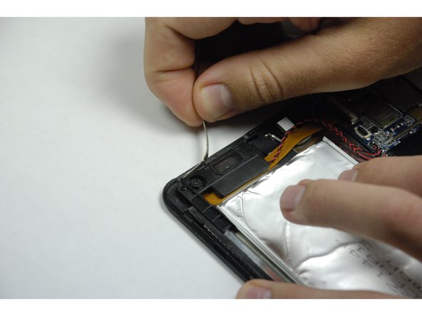

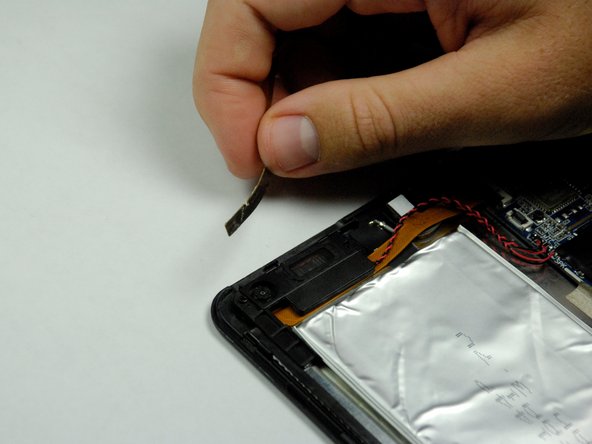

    3. Trio Stealth G4 Volume Buttons Replacement: crwdns2935265:08crwdnd2935265:01crwdnd2935265:03crwdne2935265:0 Trio Stealth G4 Volume Buttons Replacement: crwdns2935265:08crwdnd2935265:02crwdnd2935265:03crwdne2935265:0 Trio Stealth G4 Volume Buttons Replacement: crwdns2935265:08crwdnd2935265:03crwdnd2935265:03crwdne2935265:0
      • Use your fingers to carefully peel the volume sensors away from the top of the plastic L-shaped speaker housing.
