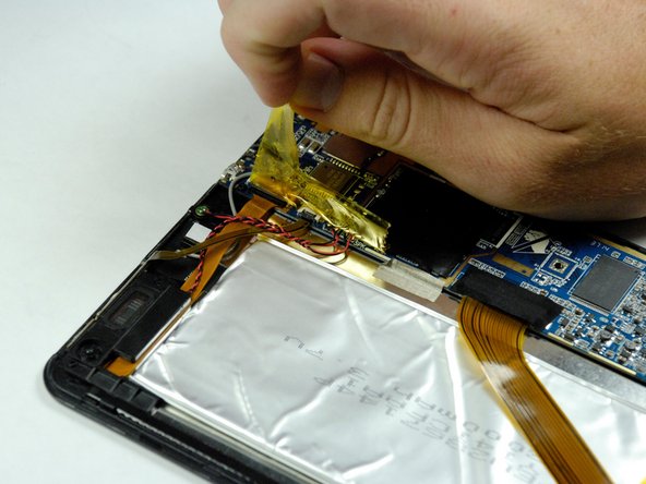

    • Remove the yellow tape covering the set of wires located near the upper right corner of the battery.

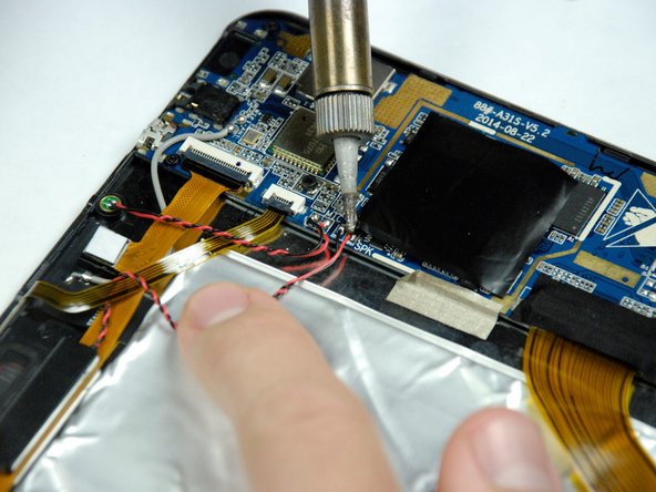

    • Use the soldering iron to melt away the solder from the red and black wires that connect the speaker to the motherboard.
    • Once the solder is completely removed, pull the wires away from the motherboard.

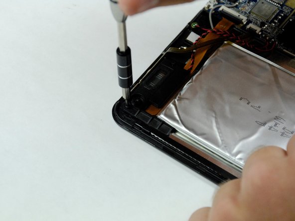

    • Use a J000 Phillips head screwdriver to remove the two 4.3 mm screws securing the speaker to the device and set them aside.

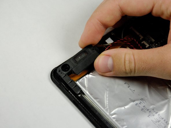

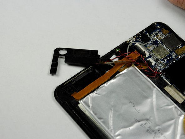

    • Use your fingers to remove the plastic L-shaped speaker housing from the tablet.
