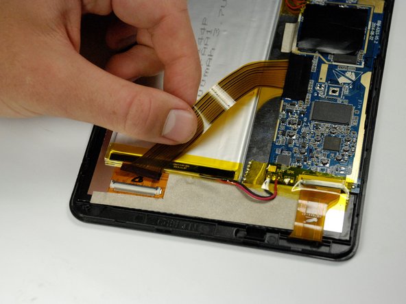

    1. Trio Stealth G4 Battery Replacement, Battery: crwdns2935265:06crwdnd2935265:01crwdnd2935265:01crwdne2935265:0
      • Remove the black tape covering the zero insertion force (ZIF) connector that holds down the end of the yellow colored ribbon wire that lies across the battery.

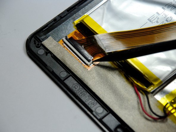

    2. Trio Stealth G4 Battery Replacement: crwdns2935265:07crwdnd2935265:01crwdnd2935265:03crwdne2935265:0 Trio Stealth G4 Battery Replacement: crwdns2935265:07crwdnd2935265:02crwdnd2935265:03crwdne2935265:0 Trio Stealth G4 Battery Replacement: crwdns2935265:07crwdnd2935265:03crwdnd2935265:03crwdne2935265:0
      • Wedge a spudger underneath the black flap on the ZIF connector and flip it up.
      • Once the flap is up, use your fingers to disconnect the end of the ribbon wire from the connector.

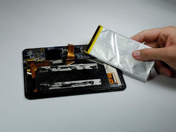

    5. Trio Stealth G4 Battery Replacement: crwdns2935265:010crwdnd2935265:01crwdnd2935265:02crwdne2935265:0 Trio Stealth G4 Battery Replacement: crwdns2935265:010crwdnd2935265:02crwdnd2935265:02crwdne2935265:0
      • Use the spudger to gently dislodge the battery from the tablet.
      • Do not bend the lithium-ion battery. This can cause a fire.
