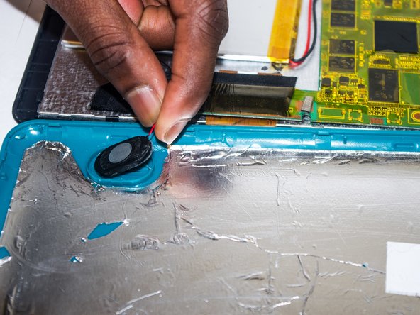

  4. Trio Stealth G2 Hype Screen Replacement, Speakers: crwdns2935265:04crwdnd2935265:01crwdnd2935265:02crwdne2935265:0 Trio Stealth G2 Hype Screen Replacement, Speakers: crwdns2935265:04crwdnd2935265:02crwdnd2935265:02crwdne2935265:0
    • Carefully peel the tape holding down the wires connected to the speaker.
  5. Trio Stealth G2 Hype Screen Replacement: crwdns2935265:05crwdnd2935265:01crwdnd2935265:01crwdne2935265:0
    • In order to replace the speakers after they are removed, you must solder the wires back onto the motherboard.
    • The red wire must be soldered onto the "+" terminal while the black wire must be terminal must be soldered onto the "-" terminal.
    • Pull the speaker and wires from the motherboard.

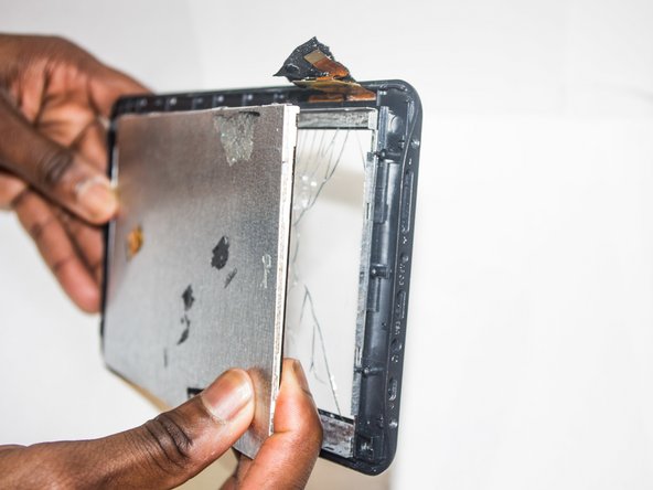

  11. Trio Stealth G2 Hype Screen Replacement, Screen/Digitizer: crwdns2935265:011crwdnd2935265:01crwdnd2935265:02crwdne2935265:0 Trio Stealth G2 Hype Screen Replacement, Screen/Digitizer: crwdns2935265:011crwdnd2935265:02crwdnd2935265:02crwdne2935265:0
    • To separate the screen from its casing, hold the device at its corners and gently pull them apart.
    • Carefully but firmly pull the screen out of the casing.
  12. Trio Stealth G2 Hype Screen Replacement, Digitizer: crwdns2935265:012crwdnd2935265:01crwdnd2935265:01crwdne2935265:0
    • After pulling out the screen, what you have left is the digitizer, which is what allows the tablet to recognize your touch.
