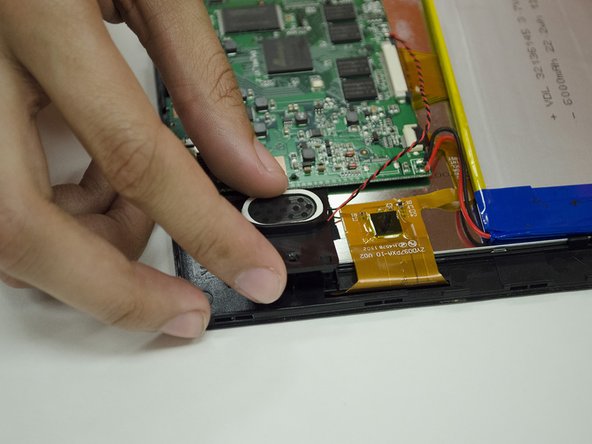

  12. Trio STEALTH-9 Motherboard Replacement, Speaker: crwdns2935265:012crwdnd2935265:01crwdnd2935265:01crwdne2935265:0
    • Slowly remove the electrical tape holding down the Speaker wires.
  13. Trio STEALTH-9 Motherboard Replacement: crwdns2935265:013crwdnd2935265:01crwdnd2935265:02crwdne2935265:0 Trio STEALTH-9 Motherboard Replacement: crwdns2935265:013crwdnd2935265:02crwdnd2935265:02crwdne2935265:0
    • Remove the #00 screw on the Speaker mount and remove the Speaker mount.
  14. Trio STEALTH-9 Motherboard Replacement: crwdns2935265:014crwdnd2935265:01crwdnd2935265:01crwdne2935265:0
    • Prepare your Soldering tools. Desolder the Speaker leads from the Motherboard.
    • Remove any excess solder as necessary, and apply new solder when replacing a Speaker.

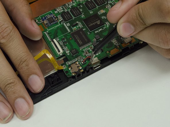

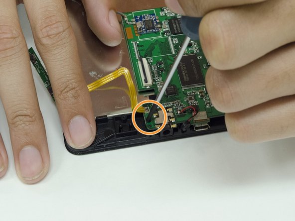

  15. Trio STEALTH-9 Motherboard Replacement, Motherboard: crwdns2935265:015crwdnd2935265:01crwdnd2935265:01crwdne2935265:0
    • Prepare your Desoldering Tools. Remove the grey wire attached to the Motherboard.
    • Remove any excess solder as needed.

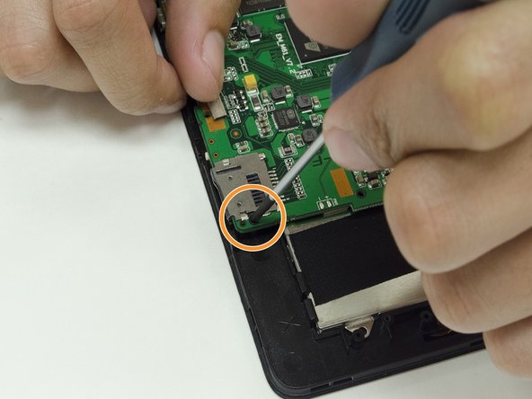

  16. Trio STEALTH-9 Motherboard Replacement: crwdns2935265:016crwdnd2935265:01crwdnd2935265:03crwdne2935265:0 Trio STEALTH-9 Motherboard Replacement: crwdns2935265:016crwdnd2935265:02crwdnd2935265:03crwdne2935265:0 Trio STEALTH-9 Motherboard Replacement: crwdns2935265:016crwdnd2935265:03crwdnd2935265:03crwdne2935265:0
    • Remove the three #00 Screws holding down the Motherboard.

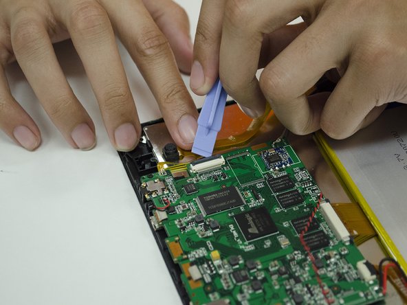

  17. Trio STEALTH-9 Motherboard Replacement: crwdns2935265:017crwdnd2935265:01crwdnd2935265:02crwdne2935265:0 Trio STEALTH-9 Motherboard Replacement: crwdns2935265:017crwdnd2935265:02crwdnd2935265:02crwdne2935265:0
    • Use a pair of Tweezers to carefully pull the side buttons away from the frame.
    • Use the same Tweezers to carefully pull the microphone away from the front of the frame.

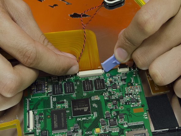

  18. Trio STEALTH-9 Motherboard Replacement: crwdns2935265:018crwdnd2935265:01crwdnd2935265:03crwdne2935265:0 Trio STEALTH-9 Motherboard Replacement: crwdns2935265:018crwdnd2935265:02crwdnd2935265:03crwdne2935265:0 Trio STEALTH-9 Motherboard Replacement: crwdns2935265:018crwdnd2935265:03crwdnd2935265:03crwdne2935265:0
    • Use your fingernails or a plastic opening tool to remove any remaining ribbon cables from the Motherboard.
  19. Trio STEALTH-9 Motherboard Replacement: crwdns2935265:019crwdnd2935265:01crwdnd2935265:01crwdne2935265:0
    • With the cables removed, lift the Motherboard off of the frame.
    • Repair or replace the Motherboard as needed.
