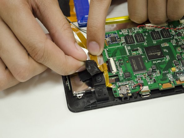

      • Slowly remove the two pieces of electrical tape holding down the Camera ribbon cable.
    2. Trio STEALTH-9 Camera Replacement: crwdns2935265:06crwdnd2935265:01crwdnd2935265:02crwdne2935265:0 Trio STEALTH-9 Camera Replacement: crwdns2935265:06crwdnd2935265:02crwdnd2935265:02crwdne2935265:0

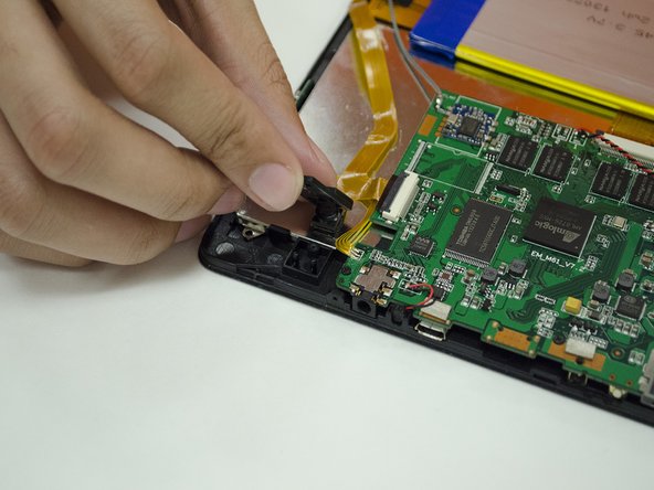

      • Remove the #00 Screw holding down the Camera mount, then remove the Camera mount.
    3. Trio STEALTH-9 Camera Replacement: crwdns2935265:07crwdnd2935265:01crwdnd2935265:02crwdne2935265:0 Trio STEALTH-9 Camera Replacement: crwdns2935265:07crwdnd2935265:02crwdnd2935265:02crwdne2935265:0

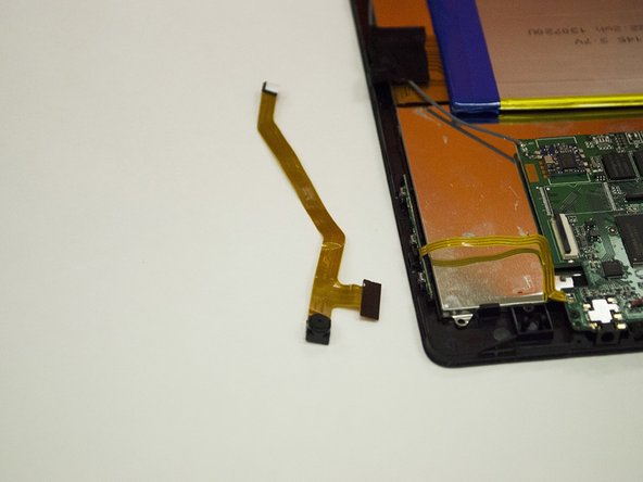

      • Detach the Camera's ribbon cable from the Motherboard using your fingernail or a plastic opening tool.
      • Remove the camera from the frame and replace as needed.
