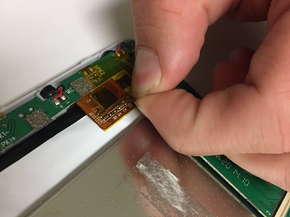

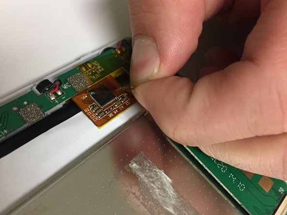

      • Located toward the bottom, carefully remove the yellow film.
    9. Trio AXS 3G Motherboard Replacement: crwdns2935265:012crwdnd2935265:01crwdnd2935265:01crwdne2935265:0
      • Gently disconnect the small ribbon found underneath the film.

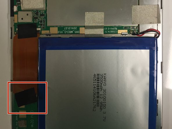

    10. Trio AXS 3G Motherboard Replacement: crwdns2935265:013crwdnd2935265:01crwdnd2935265:01crwdne2935265:0
      • There is another connection found underneath this portion of the motherboard.
      • Lifting up the motherboard, disconnect the second ribbon found underneath.

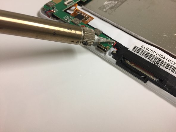

    11. Trio AXS 3G Motherboard Replacement: crwdns2935265:014crwdnd2935265:01crwdnd2935265:02crwdne2935265:0 Trio AXS 3G Motherboard Replacement: crwdns2935265:014crwdnd2935265:02crwdnd2935265:02crwdne2935265:0
      • Using a soldering tool, melt the six metal connections located towards the bottom of the tablet.
      • Do not melt the wires.
      • Once the connections are melted, the rest of the motherboard can be removed from the tablet.
