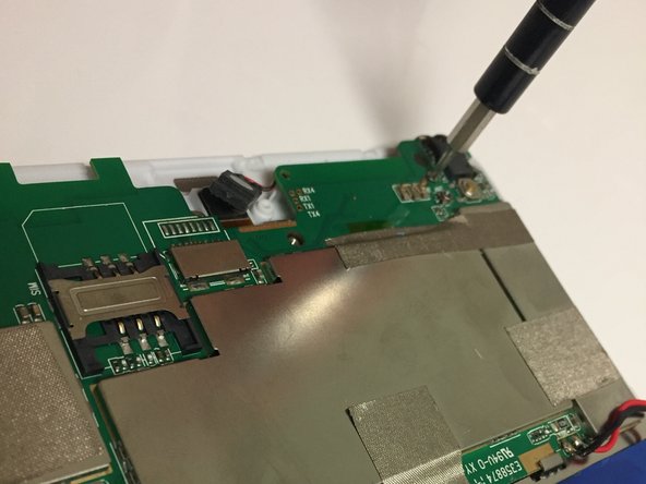

    1. Trio AXS 3G Camera Replacement, Camera: crwdns2935265:04crwdnd2935265:01crwdnd2935265:02crwdne2935265:0 Trio AXS 3G Camera Replacement, Camera: crwdns2935265:04crwdnd2935265:02crwdnd2935265:02crwdne2935265:0
      • Unscrew 5 #000 4 mm and 3 mm screws around the strip.
    2. Trio AXS 3G Camera Replacement: crwdns2935265:05crwdnd2935265:01crwdnd2935265:01crwdne2935265:0
      • Undo the tape on top of the connector from the camera to motherboard.
    3. Trio AXS 3G Camera Replacement: crwdns2935265:06crwdnd2935265:01crwdnd2935265:01crwdne2935265:0
      • Slightly lift up the motherboard.

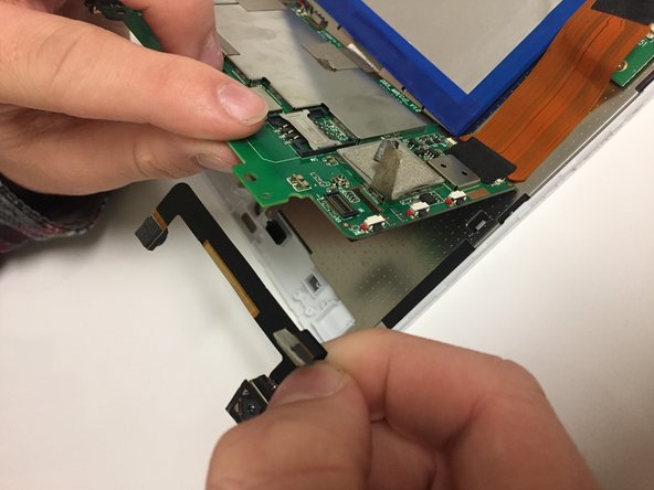

    4. Trio AXS 3G Camera Replacement: crwdns2935265:07crwdnd2935265:01crwdnd2935265:02crwdne2935265:0 Trio AXS 3G Camera Replacement: crwdns2935265:07crwdnd2935265:02crwdnd2935265:02crwdne2935265:0
      • Disconnect the camera from the motherboard on the topside and pull the camera strip out.
