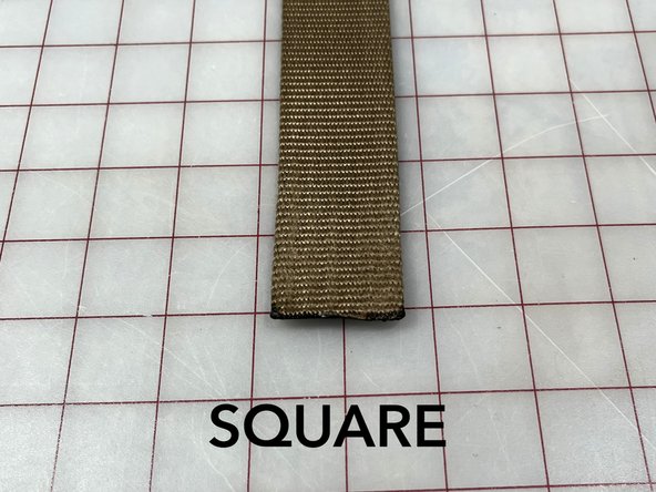

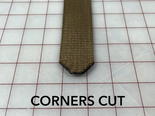

  3. Trim a Webbing Belt, Draw the tip design: crwdns2935265:03crwdnd2935265:01crwdnd2935265:03crwdne2935265:0 Trim a Webbing Belt, Draw the tip design: crwdns2935265:03crwdnd2935265:02crwdnd2935265:03crwdne2935265:0 Trim a Webbing Belt, Draw the tip design: crwdns2935265:03crwdnd2935265:03crwdnd2935265:03crwdne2935265:0
    • There are three standard tip designs with different aesthetics and functionality:
    • 45 Degree or Point - This tip design is the easiest to feed through a buckle, but has the highest likelihood of fraying in the future.
    • Square End - This tip design is the least likely to fray.
    • Corners Cut - This is a hybrid of the point and square designs.
    • Draw the desired tip design at the mark made in Step 2 with chalk or a heat-erasable pen.

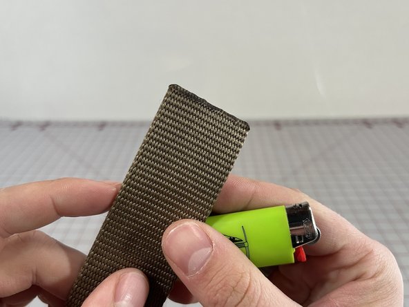

    • If needed, use a lighter to melt and soften the melted edge on both sides until it has the desired smoothness.
    • Allow the belt to fully cool.
    • This method can also be used to repair any future fraying.

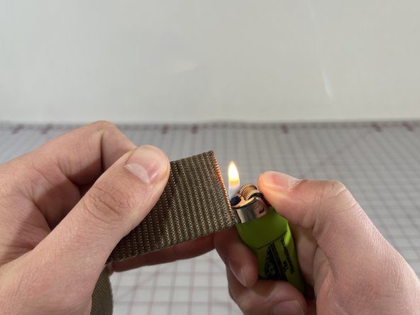

  4. Trim a Webbing Belt, Alternative method: crwdns2935265:06crwdnd2935265:01crwdnd2935265:03crwdne2935265:0 Trim a Webbing Belt, Alternative method: crwdns2935265:06crwdnd2935265:02crwdnd2935265:03crwdne2935265:0 Trim a Webbing Belt, Alternative method: crwdns2935265:06crwdnd2935265:03crwdnd2935265:03crwdne2935265:0
    • To shorten a webbing belt without a hot knife:
    • Follow the marking instructions in Steps 2 and 3.
    • Cut along the line with a pair of sharp scissors.
    • Then use the technique in Step 5 to melt the cut edge until it's fully encased and no frayed pieces remain.
