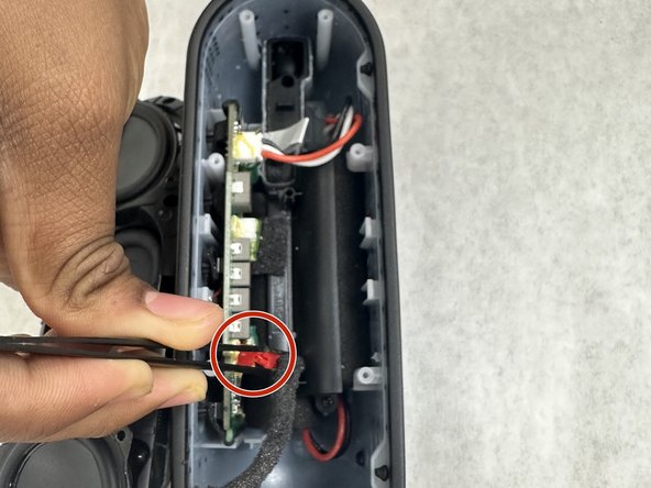

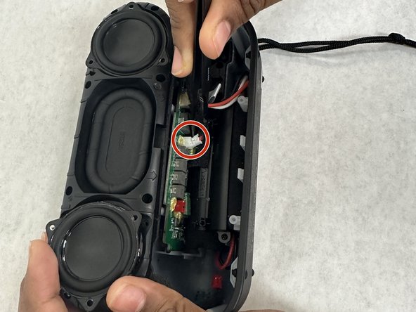

    • Remove the 14 Phillips screws around the perimeter of the speaker.
  3. Tribit XSound Go TS-BTS20 Speaker Replacement: crwdns2935265:03crwdnd2935265:01crwdnd2935265:03crwdne2935265:0 Tribit XSound Go TS-BTS20 Speaker Replacement: crwdns2935265:03crwdnd2935265:02crwdnd2935265:03crwdne2935265:0 Tribit XSound Go TS-BTS20 Speaker Replacement: crwdns2935265:03crwdnd2935265:03crwdnd2935265:03crwdne2935265:0
    • Disconnect both wires connected to speakers and motherboard.
