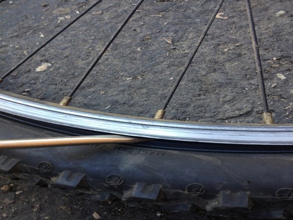

  7. Trek 820 Spokes Replacement: crwdns2935265:08crwdnd2935265:01crwdnd2935265:02crwdne2935265:0 Trek 820 Spokes Replacement: crwdns2935265:08crwdnd2935265:02crwdnd2935265:02crwdne2935265:0
    • Insert the flathead screwdriver, or another sturdy, long object, between the edge of the tire and the wheel rim.
    • Be careful not to damage the inner tube when inserting and moving the screwdriver or other tool. The inner tube is fragile and may be pinched between the wheel rim and tool.
    • Work the edge of the tire out of the wheel rim using a screwdriver, pulling the edge of the tire away from the center of the wheel and out of the rim.

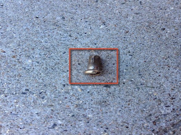

    • Slowly peel back the layer of rubber that covers the 32 screws on the wheel.

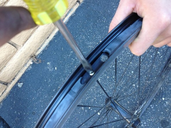

  11. Trek 820 Spokes Replacement: crwdns2935265:012crwdnd2935265:01crwdnd2935265:03crwdne2935265:0 Trek 820 Spokes Replacement: crwdns2935265:012crwdnd2935265:02crwdnd2935265:03crwdne2935265:0 Trek 820 Spokes Replacement: crwdns2935265:012crwdnd2935265:03crwdnd2935265:03crwdne2935265:0
    • Remove the screw using the flathead screwdriver.
    • You will need to alternate between steps #12 and #13 repeatedly because the spokes have to be removed one at a time.
    • All screws will be the same size.
    • Only remove the screws of the spokes you are replacing.

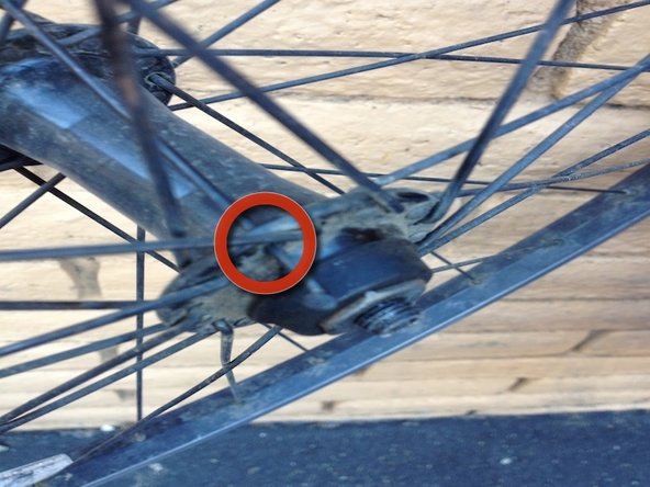

  12. Trek 820 Spokes Replacement: crwdns2935265:013crwdnd2935265:01crwdnd2935265:03crwdne2935265:0 Trek 820 Spokes Replacement: crwdns2935265:013crwdnd2935265:02crwdnd2935265:03crwdne2935265:0 Trek 820 Spokes Replacement: crwdns2935265:013crwdnd2935265:03crwdnd2935265:03crwdne2935265:0
    • Once a screw is removed, if that spoke did not fall out, gently remove it from the wheel.
    • Maneuver the spoke so that it is perpendicular to the plane of the wheel, then slide the spoke out.

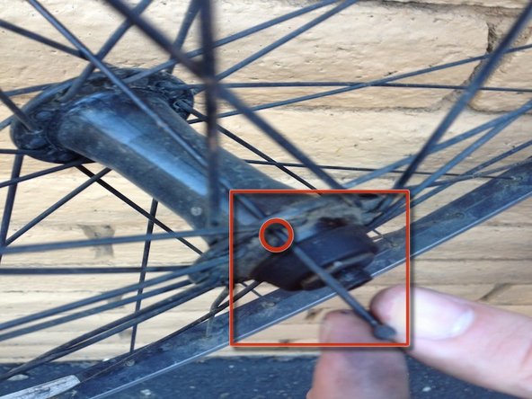

  13. Trek 820 Spokes Replacement: crwdns2935265:014crwdnd2935265:01crwdnd2935265:01crwdne2935265:0
    • Insert the new spoke into the empty hole on the hub.
    • If you are replacing multiple spokes, you will need to alternate between steps #14 and #15. The spokes must be replaced one at a time.
  14. Trek 820 Spokes Replacement: crwdns2935265:015crwdnd2935265:01crwdnd2935265:01crwdne2935265:0
    • Use the flathead screwdriver with the screw removed in step #12 to attach the spoke to the wheel, securing it in place.
