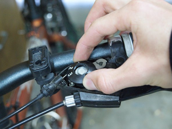

    • Free the end of the cable from the shifter.
    • Trick: use pliers or vise grips to hold the cable in front of the shifter mechanism.
    • Downshift while holding the cable.
    • The end is forced out!

    • Reassemble the shifter, putting back the indicator, the case, and their corresponding screws
