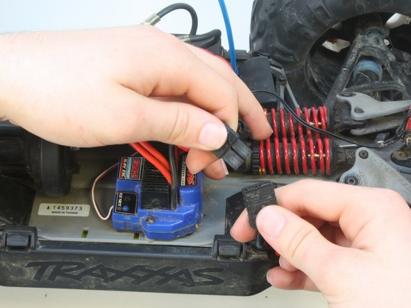

    • Disconnect the battery from the device by pulling the black plastic connector apart.

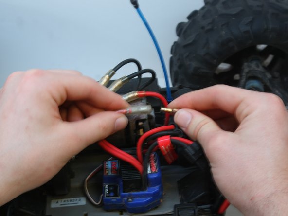

  4. Traxxas Summit Steering Assembly Servo Replacement: crwdns2935265:04crwdnd2935265:01crwdnd2935265:03crwdne2935265:0 Traxxas Summit Steering Assembly Servo Replacement: crwdns2935265:04crwdnd2935265:02crwdnd2935265:03crwdne2935265:0 Traxxas Summit Steering Assembly Servo Replacement: crwdns2935265:04crwdnd2935265:03crwdnd2935265:03crwdne2935265:0

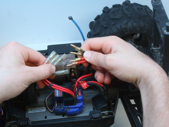

    • Disconnect the four power cables that connect the motor to the electronic speed control.
    • Grab the connectors by their rubber covered metal ends rather than the wire if possible.

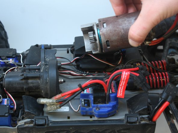

  5. Traxxas Summit Steering Assembly Servo Replacement: crwdns2935265:05crwdnd2935265:01crwdnd2935265:03crwdne2935265:0 Traxxas Summit Steering Assembly Servo Replacement: crwdns2935265:05crwdnd2935265:02crwdnd2935265:03crwdne2935265:0 Traxxas Summit Steering Assembly Servo Replacement: crwdns2935265:05crwdnd2935265:03crwdnd2935265:03crwdne2935265:0

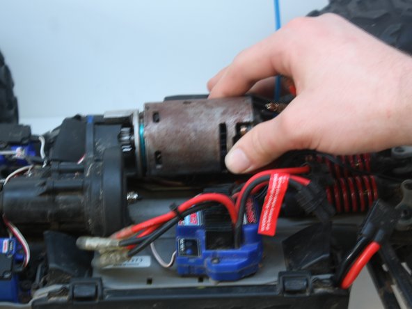

    • Unscrew the single 15.5mm long retaining bolt from the motor with the 3mm hex key.
    • Remove the motor by wiggling back and forth while pulling it to the right and up.

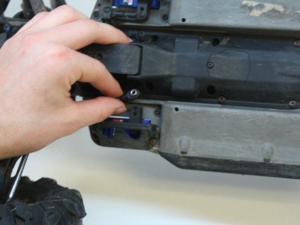

    • Flip the car on its back to provide access to the steering assembly.
  7. Traxxas Summit Steering Assembly Servo Replacement: crwdns2935265:07crwdnd2935265:01crwdnd2935265:03crwdne2935265:0 Traxxas Summit Steering Assembly Servo Replacement: crwdns2935265:07crwdnd2935265:02crwdnd2935265:03crwdne2935265:0 Traxxas Summit Steering Assembly Servo Replacement: crwdns2935265:07crwdnd2935265:03crwdnd2935265:03crwdne2935265:0
    • Unscrew the servo arm from the steering assembly by removing the 16.3mm long screw with a 2mm hex key.
    • Pull the connecting linkage out of the steering horn.

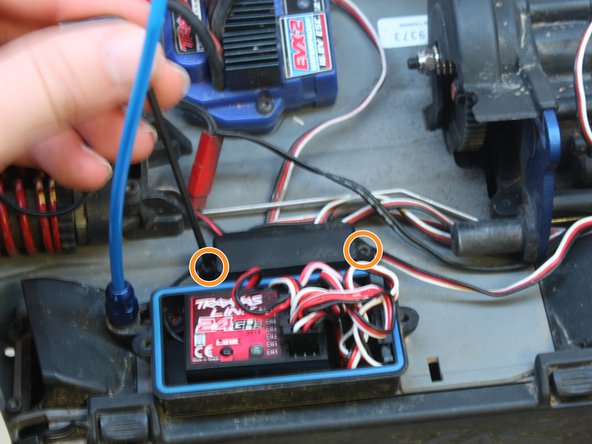

  8. Traxxas Summit Steering Assembly Servo Replacement: crwdns2935265:08crwdnd2935265:01crwdnd2935265:03crwdne2935265:0 Traxxas Summit Steering Assembly Servo Replacement: crwdns2935265:08crwdnd2935265:02crwdnd2935265:03crwdne2935265:0 Traxxas Summit Steering Assembly Servo Replacement: crwdns2935265:08crwdnd2935265:03crwdnd2935265:03crwdne2935265:0
    • Flip the car back upright.

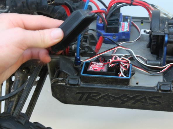

    • Remove the two 7mm long screws retaining the largest wiring cover with the 2mm hex key.
    • Take the largest wiring cover off.
    • Remove the two 7mm long screws retaining the smaller wiring cover with the 2mm hex key.

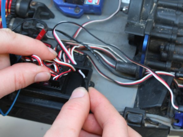

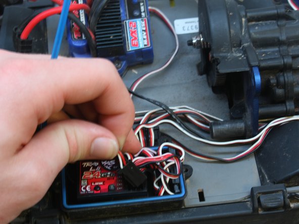

  9. Traxxas Summit Steering Assembly Servo Replacement: crwdns2935265:09crwdnd2935265:01crwdnd2935265:03crwdne2935265:0 Traxxas Summit Steering Assembly Servo Replacement: crwdns2935265:09crwdnd2935265:02crwdnd2935265:03crwdne2935265:0 Traxxas Summit Steering Assembly Servo Replacement: crwdns2935265:09crwdnd2935265:03crwdnd2935265:03crwdne2935265:0
    • Remove the second wiring cover.
    • Pull the servo connecter out of the receiver.
    • Work the cable out of the receiver box.
